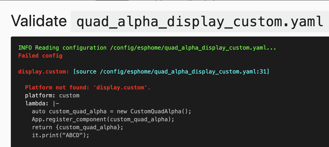

This is what I’ve tried so far, but it won’t compile
yaml:
esphome:
  platform: ESP32
  board: esp32doit-devkit-v1
  includes:
    - quad_alpha_display_custom/quad_alpha_custom.h
i2c:
  sda: GPIO21
  scl: GPIO22
display:
  - platform: custom
    lambda: |-
      auto custom_quad_alpha = new CustomQuadAlpha();
      App.register_component(custom_quad_alpha);
      return {custom_quad_alpha};
      it.print("ABCD");

I know the class definition isn’t correct, pretty sure I need something after public Component, but not sure what. Basically needs to accept the characters from the it.print("") statement. I also know I need to expand the loop code, but just trying to get the structure correct first.
Any help would be greatly appreciated!
Thanks to @ssieb who has created a custom component for this.
https://github.com/ssieb/custom_components/tree/master/lcd_ht16k33
I will try and test it on the weekend.
the link has changed to
I’ve been using it for years and still going strong!
