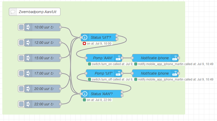

I just made a very basic flow for the pump of my Intex swimming pool in the backyard.
It’s working, but I think i can be made easier than what I’ve done.
What do I want to achieve with this flow?
- At given times, (10:00, 13:00, 16:00, 19:00, 22:00 hrs) the smartplug in which the pump is plugged in goes ‘on’ so the pump will start running. Lastly, a notification will be sent to my smartphone.
- After 90 minutes, the smartplug switches off. Again, a notification will be sent to my smartphone.
Then the above will happen again at the next time indicated, etc.
I think I made the flow harder and bigger than necessary.
How can I make this flow more simple? And with what nodes?
This is the flow I created:
Some advice would be greatly appreciated! ![]()
