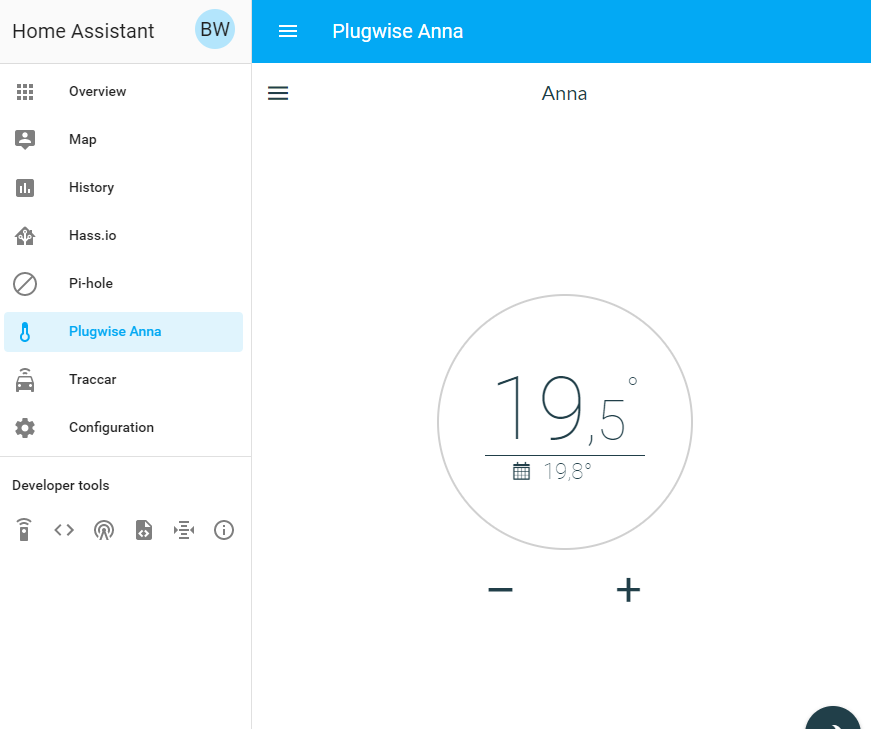

UPDATE: while actually trying this I found out that the login and password must be entered every time when a new browser session is opened :frowning:
Or, I was thinking, why not put the whole webpage in HA?
panel_iframe:
  anna:
    title: Plugwise Anna
    icon: mdi:thermometer
    url: http://192.168.xxx.yyy
There is a limitation, this only works when being connected to the home network.
There might be ways around this but I haven’t had time to investigate…
