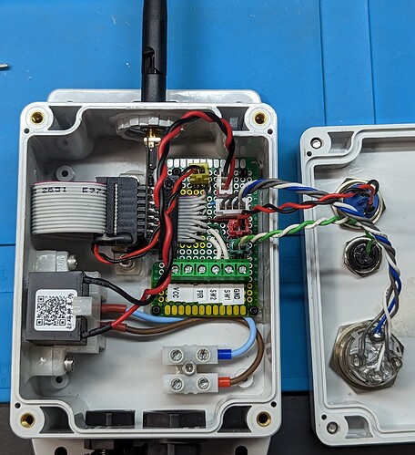

I’ve made a zigbee router / extender that reaches up to my front gate, and also has some sensors to tell me if I’ve got mail, junk mail or a parcel, and also display a mailbox status light, with a reset button when I clear the mailbox…
Uses the custom firmware builder at ptvo.info
Wow, that is impressive. I wish I had the knowledge to do that, I am trying to get my Zigbee signal to reach the basement from the 2nd floor with my wife’s requirement “DO NOT CHANGE ANY LIGHT SWITCH ON THE 1st FLOOR”.
I thought I could use an Sonoff ZigbeeMini like I did on the 3rd and 2do floors, but since I have almost just 2-way light switch between the stairs and the 1st floor. This will not be possible.
