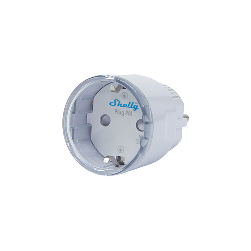

Shelly has good variety of power monitoring devices without relay.

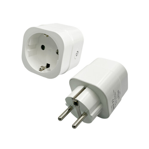

Atomtech has power monitor plugs without relay (never tried personally).
