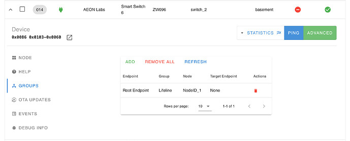

To figure out what is going on, a first step is to review the device configuration settings and make sure the lifeline is configured. Do any of the other sensors update - power, voltage, etc.?
I have tried removing it and re-adding it again, but didnt seem to make a difference… Checked the Lifeline and it seems correct, all the other sensors update as they should… I get the wattage and voltage etc etc as expected… just not the toggle switch event…
