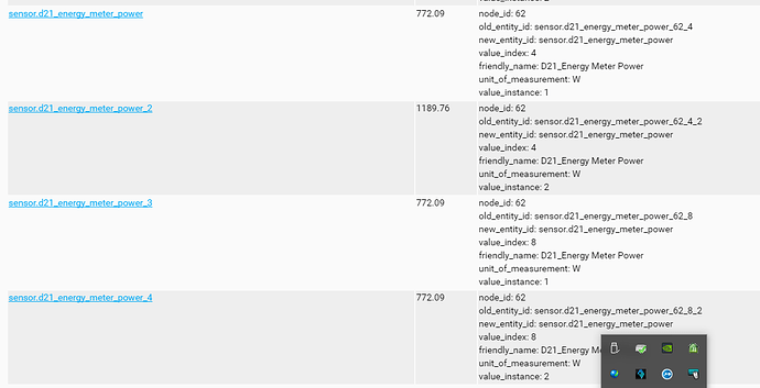

Messed around a bunch more with the settings but still no luck. It’s read correctly when HASS starts up, but doesn’t ever update again. OZWCP shows a near real-time update to the watts and other info. Other thing that’s odd in HASS is there are at least 2 of each value. Example:
That’s ONE energy meter. I assume it should have 3 values, one for each leg then a total. No idea why there are more than that. And still don’t know why it’s not updating.

Can someone tell me what each sensor represents? I have three that show the same thing (and change every 30 seconds), then the #2 sensor shows a higher value that never updates. Thanks.

the reason you getting a bunch of sensor its because you using the standard xml setup
