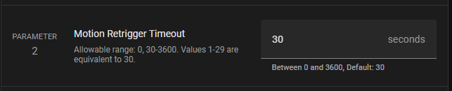

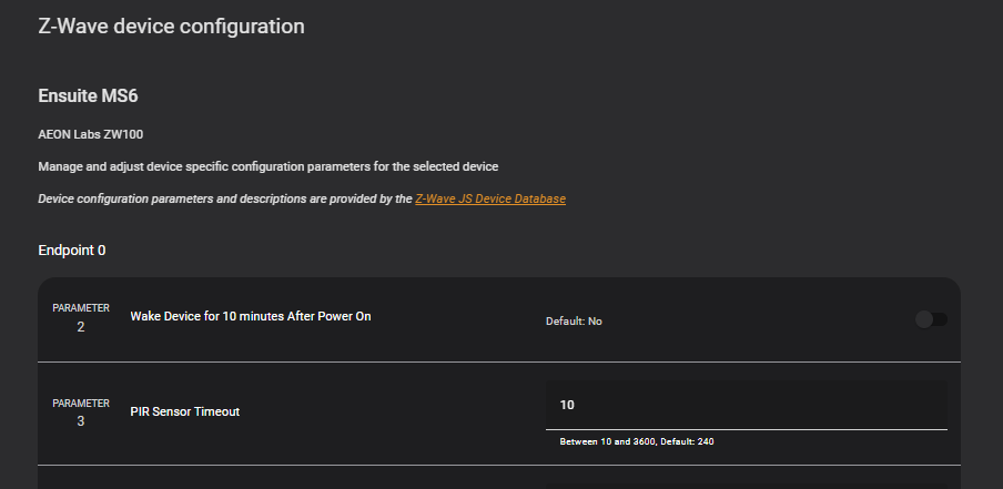

Did you hear back from them? I have a multi sensor 7 and the motion detected trigger stays on for about 25sec after there is no motion
What have you got set in the device config though?
The minimum timeout on the MS7 is 30 seconds, so that is the expected behaviour
I’ve set this one to 0 which in theory should disable it. Seems like it stays on for the time set in parameter 3 but you can’t disable it or even set it lower than 30sec
