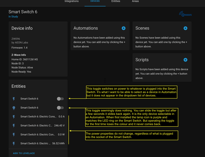

But I’ve run into a problem with an Aeotec Z-Wave Smart Switch 6. I’ve included it with no problem but I note that under devices one Smart Switch 6 appears and clicking on that I see the following:
As you can (hopefully) see there are 2 Smart Switch entities - one with a lamp icon and the other with a flash icon. (And one set of power icons.)
The lamp icon is the only one selectable in an automation. And it does nothing. Even selecting through the GUI does nothing. The Flash icon one, when that is clicked in the GUI does turn the switch on; exactly what I want. But how do I select this in an automation? Looking at the Entities list I see the following:
I’ve changed the name in the automations yaml to ‘switch’ from ‘light’. But it still doesn’t turn the switch on.
I know I’m doing something fundamentally wrong but I’m not familiar enough with HA yet to know what. Can anyone help?
One is the led on the device and the other is the actual switch. At least that’s how it’s supposed to be :slight_smile: does the light actually work, do values update at all, does it update anything when you manually turn it on by using the physical button?
Thanks for the response. That makes sense. Clicking the device with the lamp icon seemingly does nothing other than the HA slide switch moving to the right then automatically moving back a few seconds later. The Aeotec Smart Switch has its purple LED ring lit and does nothing.
Clicking the device with the flash icon switches the Aeotec Smart Switch LED ring on (changes to green) and the power flows to whatever is plugged into the Smart Switch. Also, the HA slide switch moves to the right and stays there. Essentially, it is acting perfectly normally. No errors. All other similar Z-Wave switch devices (POPP, TKB, Everspring) work perfectly and each presents only one device selectable in an Automation which, if clicked, switches the power on to whatever is plugged into it.
For the Smart Switch I am only presented with the device with the lamp icon in an automation. And that does nothing. I’m wondering how Automation selects the items for its ‘pick list’ of valid devices to use…
Ps. None of the power values change, even when something is plugged into the Smart Switch. Although I don’t plan to use them anyway, I just want control the switch State from off to on and vice versa.

This three screenshots may be helpful in explaining the issue further. I’m now beginning to think that there is an issue with the Z-wave JS integration module not correctly recognising the Aeotec Smart Switch as I’m not encountering the problem with other switches.
Can you rename the LED toggle to “Smart Switch 6 LED” for better clarification in the dropdown lists? And please provide a screenshot of the full dropdown list afterwards (all actions for the “Smart Switch 6” device)
Renamed for clarity. (Should have done this earlier.) Screenshots attached. HOWEVER… I have found a workaround (or maybe it’s the way it should have been done in the first place). If I write a scene rather than an Automation and select Device, as with Automation the Smart Switch 6 comes up again. But upon selection both entities - Smart Switch 6 and Smart Switch LED - appear in a dropdown. I can then select Smart Switch 6 and pick the state I want the device to be in after running the scene - i.e. Power On. It’s then a simple matter of calling the scene from the Automation. Not as straightforward as direct selection in an Automation but it does work. (Last two screen shots refer.)

Did you maybe miss the scroll bar in the automation dropdrown list?
You’re referring to the Action Type drop down list? Starting with Condition and ending with the tenth item - Device? No, I was aware of the scroll bar and I did scroll down the list but on selecting Device I was expecting both instances of the Smart Switch that I saw in Devices to be listed. But only the LED one was shown and therefore selectable. as I now know, that was the wrong one. (I’ve now followed your advice and for clarity renamed both suffixing with LED and Power respectively.) What I hadn’t realised is the role Scenes could play in this. And consequently I skipped past the Activate Scene option in the drop down list. Still learning a lot about HA! When I started trying different things and realised that Scenes could set the required end state of a device property then the Activate Scene option for Automations came to mind. Still a bit unsure if this is the most efficient way to go about getting the required result but until I get heavily into scripting I won’t know. I also feel that the LED is a property of the Smart Switch and the Power is the main function. But I’ve now got the Smart Switch doing what I want to do and that’s great. Doubtless I will learn more as time progresses. Thanks very much for your help though. You put me on the right track.

I meant this scrollbar:
That should also contain the actions for the power switch, not just the LED.
The power readings also work in unsecure mode, but the parameters have to be set correctly (update interval for group 1 and group 1 meter report)
Ah! The light has dawned! Now here’s a strange thing though. I primarily use a MacBook Pro (late 2013) and access HA thru Safari. The dropdown list you specifically refer to opens up at the bottom of the page. No vertical scrollbar. Only three options available at the current zoom level of Safari. All LED. No Power. But based upon what you said I switched to Chrome. Scrollbar immediately apparent! And power options at the bottom of the list! I then reverted back to Safari. Exited. And reloaded. And the scrollbar magically appeared! Safari 14.0.3 running. (Latest version, as well as MacOS 11.2.3 Big Sur.) Go figure! (I do get the occasional glitch in Safari and typically switch to Chrome. In this case I had no idea that there were further options in the list so didn’t think to try Chrome.)
So after all that, it was there all the time. Excellent. THANK YOU! LEDs don’t work though nor updating but I’ll run through the device parameters now and set them to what you and squirtbrnr recommend. I have set a Z-Wave network key but have included devices in non-secure mode on the basis that (1) I don’t have any Z-Wave locks and (2) I’ve read that using the key significantly increases latency for devices that are included with it.
