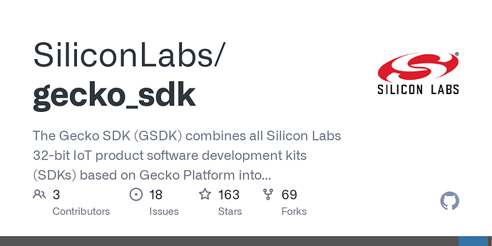

This github discussion thread has lots of info on the firmware files for s7 and Zooz sticks. I got mine from SiLabs github page and it matched the one that Aeotec offers on their site (BRD4206A).
