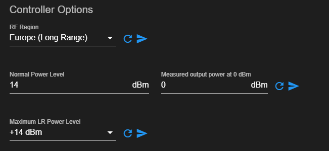

Should one choose RF Region Europe (Long Range) when in Europe (not using long range) for the Aeotec Z-Stick 10 Pro, or should this be left unselected, which is the default after I installed it in Home Assistant?

It should be on Europe (Long Range)
Also for Normal power level I was recommended +14 from Aeotec support so both on+14. My default was 0 and it improved range a lot for me.
