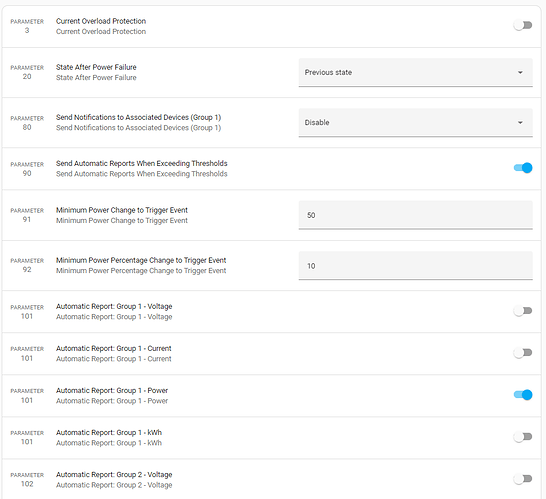

Looking for some help on what best to set these values to so I get accurate energy monitoring.

I found even with reports disabled (parameter 80) it will send power and energy reports, but to be honest I’m still trying to work out exactly what the magic combination is.

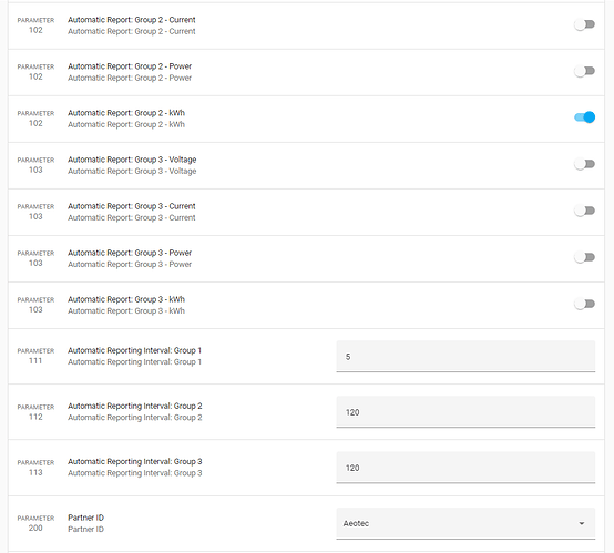

The frequency of reporting you need will depend on the use case - for some of mine I only have it update once every ten minutes.
I have a different Aoetec switch ZWA023 but it has similar config parameters. I set it to report every 10 minutes and then use the thresholds to send power data when it changes by more than 10 watts. My load is pretty static when it’s on (gas water heater), so basically that 10 watts sends me a message or two as is starts and one when it shutdowns, and maybe another one based on the 10 minute interval.
