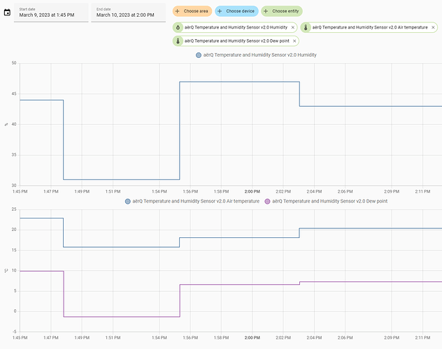

The humidity is updating as expected, but the temperature is stuck on the same reading after changing several times initially.
I have changed Param 4 to 1800, and Param 64 to Celsius.
For troubleshooting I have added large negative values to both temperature and humidity (Params 14 and 15). The humidiy reading jumps as expected, the temperature stays stuck on 25.8’C.

Here is the current log:
