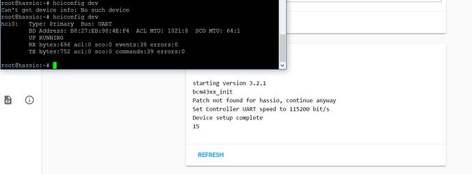

Almost similar here (after installing addon):
starting version 3.2.1
bcm43xx_init
tried the latest 0.5 version now. Still no go.
bcm43xx_init
Can’t get device info: No such device
Patch not found for BCM43438A1 37, continue anyway
Try last update:
Yes its working now. Thanks for the fix :grinning:
Fixed here also, but some devices do not show up.
I have to check why
