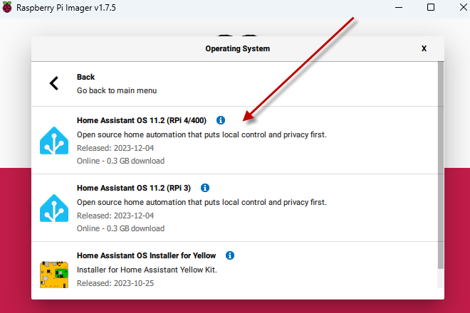

I donwloaded from Raspberry Pi imager v1,7,5 the homeassistant image and flashed it to my SSD.
HaOS that it is. So you are forced to the fat partition because of your raspberry not being able to use a journaling file system for the boot partition but needs that ancient fat one.
