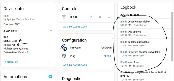

I had a power outage and when everything came up I’m having issues with most of my zwave devices, 8 blinds and all GE light switches. Zigbee seems fine and I have lots of smart things zwave sensors that are working fine. I’ve tried reseating the zwave dongle and doing a heal on the zwave network.
If I use a GE zwave light switch it will be seen by the dashboard but if I try to turn on or off with the dashboard I get the log message below. If I use the switch again it appears to be functional by HA but I get the same error even though the dashboard will update with the status of the light on or off. I can’t control any of these zwave devices with dashboard but I can manually. If I delete and add device again I get the same issue.

I’ve tried upgrading to current and that didn’t help, may have made it worse… I used to be able to control the 3 blinds that are initially seen but not after upgrades. I also restored down to the last backup and that didn’t help, I’m having the same issue. I’m now restoring back to latest, may as well but I need to get this working and hope I don’t have to redo all of my automations for all of these devices…
Home Assistant 2022.10.1 Supervisor 2022.09.1 Operating System 9.0 Frontend 20221006.0 - latest.
This is the warning message in the info tab for a light is, “This entity is no longer being provided by the zwave_js integration. If the entity is no longer in use, delete it in settings.”
The message in the log in the same window is… " became unavailable triggered by service switch.turn_on"
9:10:46 AM - 6 hours ago - xxx
Any help is appreciated as I don’t even seem to be able to start over and add the devices.
