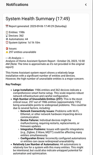

Hi all,
first, a disclaimer, this is my first github experience and first code posted for the community, so be nice but I’m always open for advises and improvements.
I have found this post of reddit https://www.reddit.com/r/homeassistant/comments/1lxcdsm/ai_log_analysis_tool_install_instructions/ and wanted to give it a try but for some reason the code presented by @ toxicstarknova was not working on my HA Yellow.
This github contains the code that I had to tweak to make it work on my HA Yellow.

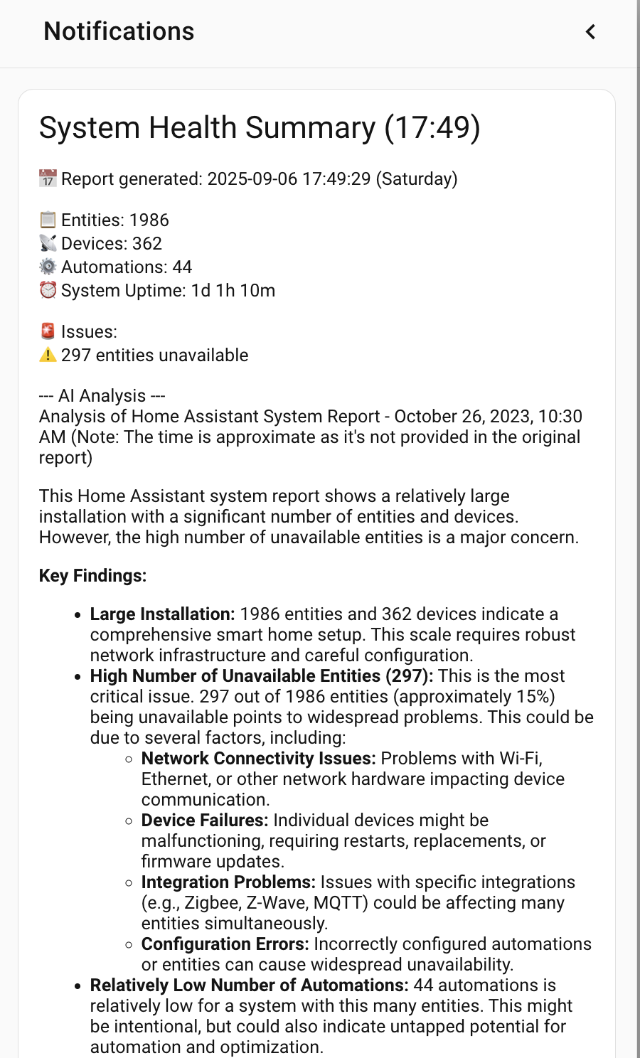

The outcome of this code is basicaly a report like this one
Let me know your sought and thanks again for @toxicstarknova for the first code
Fred

That’s nice.
Note that you may be able to do the same with the new ai_task.generate_data action introduced in release 2025.8.0 (avoiding app_deamon).
