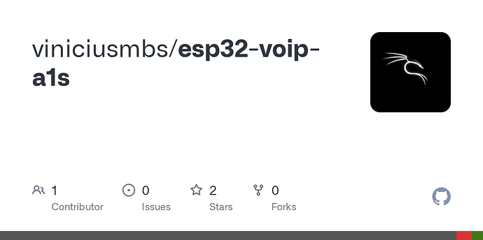

I would like to share a personal open-source project that I published on GitHub,
using the AI-Thinker ESP32 Audio Kit V2.2 board applied to a VoIP intercom system based on SIP.
Watch the complete step-by-step video
Watch on YouTube
Channel: Home Assistant PC
Video with multilingual audio
:open_file_folder: Project Repository (GitHub):
:warning: Important: Important: This project does NOT have direct/native integration with Home Assistant.
The intercom works independently, but can be used in conjunction with automations, cards, and dashboards in Home Assistant, as demonstrated in the video.
The project focuses on the assembly, installation, and configuration of the intercom, showing in practice how it can coexist with visual automations and flows in Home Assistant. ### :wrench: What the project covers: * Ubuntu installation * Installation and use of ESP-IDF and ESP-ADF * Flashing the AI-Thinker ESP32 Audio Kit V2.2 * SIP account configuration (SignalWire) * Audio and VoIP call configuration * Physical mounting of the board in the intercom * Real-world system operation For those who want to see the project in operation, I have also published a video showing the entire process step by step: Itโ€™s a project aimed at those who enjoy ESP32, embedded Linux, VoIP/SIP, automation, and real-world projects in practice. Channel: Home Assistant PC If anyone is interested in discussing improvements, project evolution, or even a possible future integration with Home Assistant, I am available.
