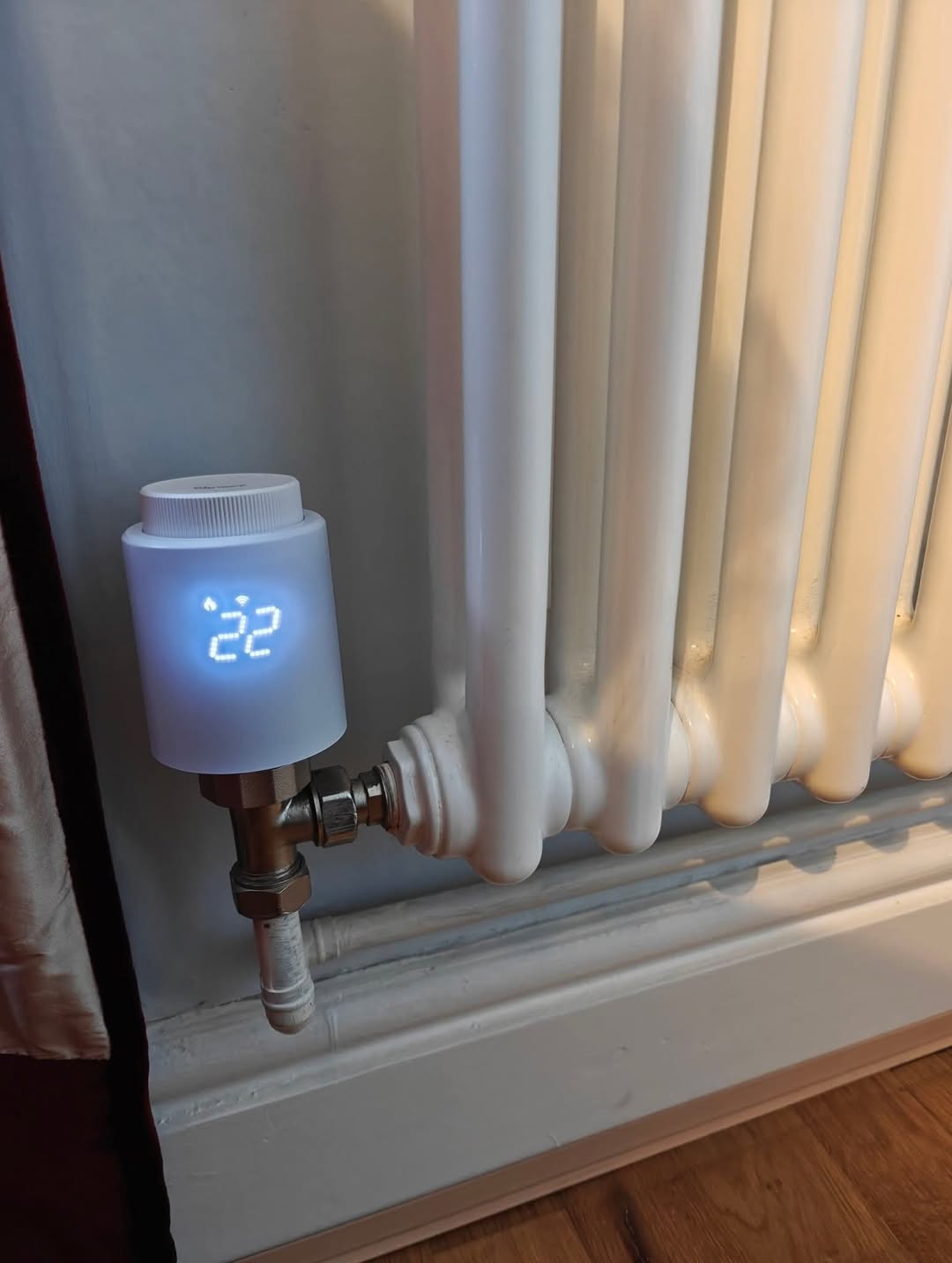

The simplest solution would have been to buy a multi-zone Honeywell system with smart TRVs on each radiator.
When a room reaches the target temperature, the TRV closes the radiator so it doesn’t overheat, while colder rooms keep heating. And when all rooms are warm and their TRVs are closed, the boiler turns off.
But I’d been wanting to get into smart home stuff for a while, so I decided to build such a system myself, of course on top of Home Assistant. I really wanted the freedom to create automations my way, not just what a closed vendor solution allows. Plus, I didn’t want to depend on any vendor cloud.
I had a Raspberry Pi 5 lying in a drawer, silently judging me for not doing anything fun with it.
So I flashed Home Assistant onto it and, in a small fit of madness, ordered:
  • TRV radiator valves
  • A relay to switch the boiler
  • A Zigbee USB dongle to control the whole circus.
Surprisingly, it all turned out much cheaper than the ready-made commercial systems.
Two weekends flew by. I went through several “generations” of heating control scripts: from the simplest “turn on the boiler if at least one TRV is open, turn it off if all are closed” to scripts that analyze how fast each room cools down depending on the outdoor temperature, use external temperature sensors, and do predictive on/off switching to smooth out temperature swings.
