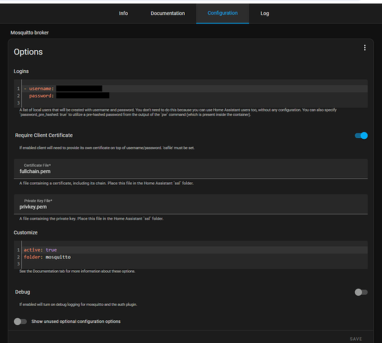

If you can point me at the debug option. I’m not using it via the add-on, but I may be able to find the option in my straight docker install.
Hi, thank you for checking.
I say I have the Homelink MQTT working, I think I do, but there isn’t any way to check (as, if i’m not mistaken, the integration works even without configuring MQTT? How do I know? :smiley: )
The debug option is just in the config for the addon, bottom right in this screenshot.
