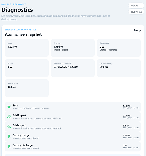

The Solar and Grid values now look good, but Home = 0 W still needs checking.

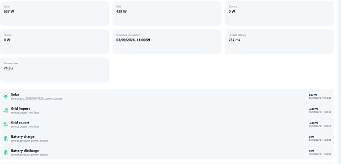

The diagnostics don’t refer to “Community support” but only “Privacy safe diagnostic report”.
report

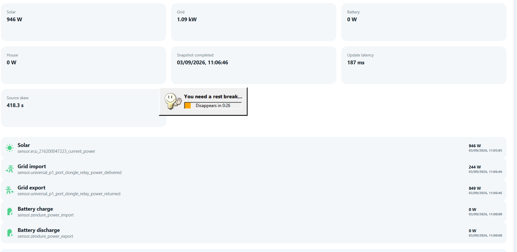

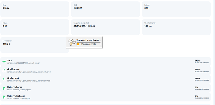

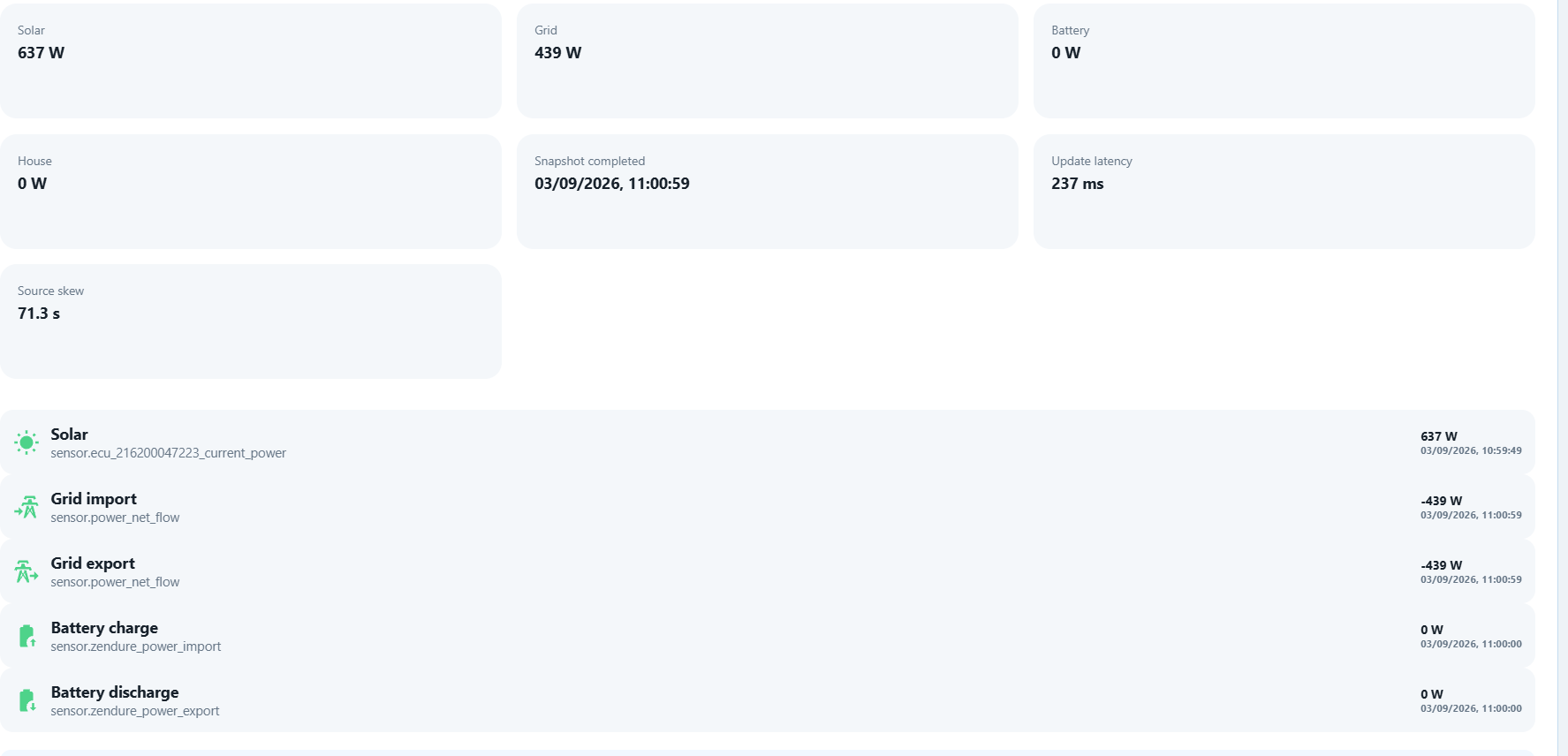

I see that the grid power (bidirectional, signed value) is somehow misinterpreted:
So (after report and screenshot above) I replaced the single sensor with split import/export but it is not better:

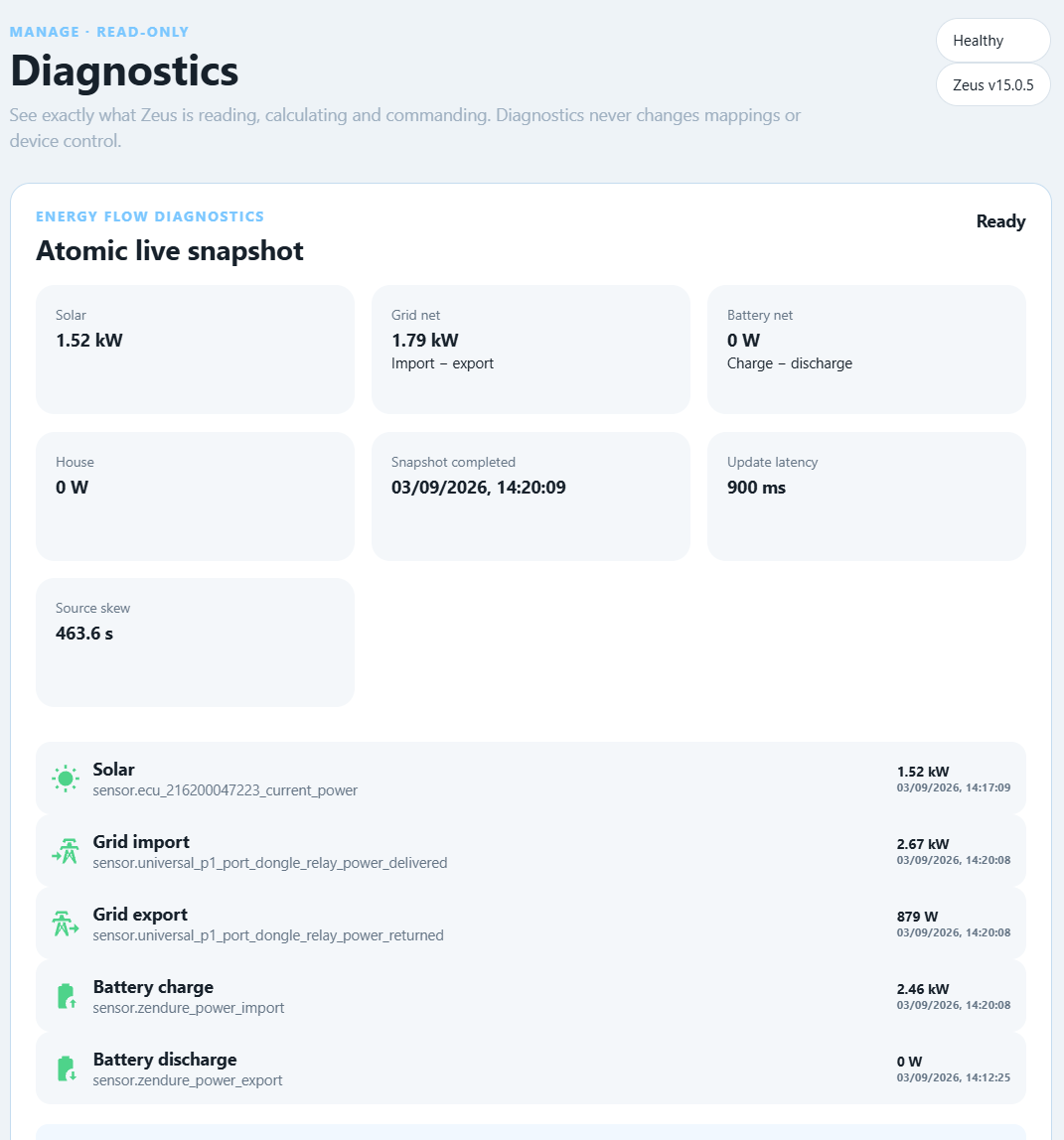

The grid balance (above the sensor values) seems to SUM the import and export.
Maybe it didn’t realise that when separate sensors are used, both are positive, always. Positive export is still export…

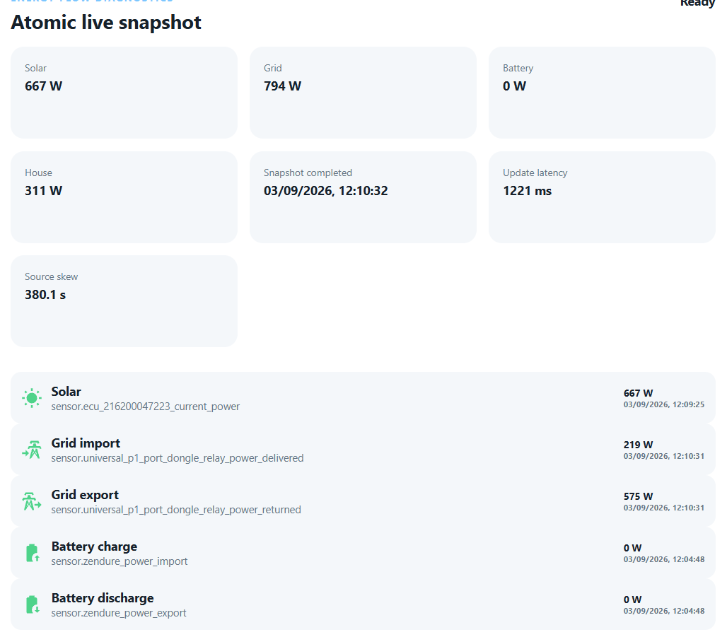

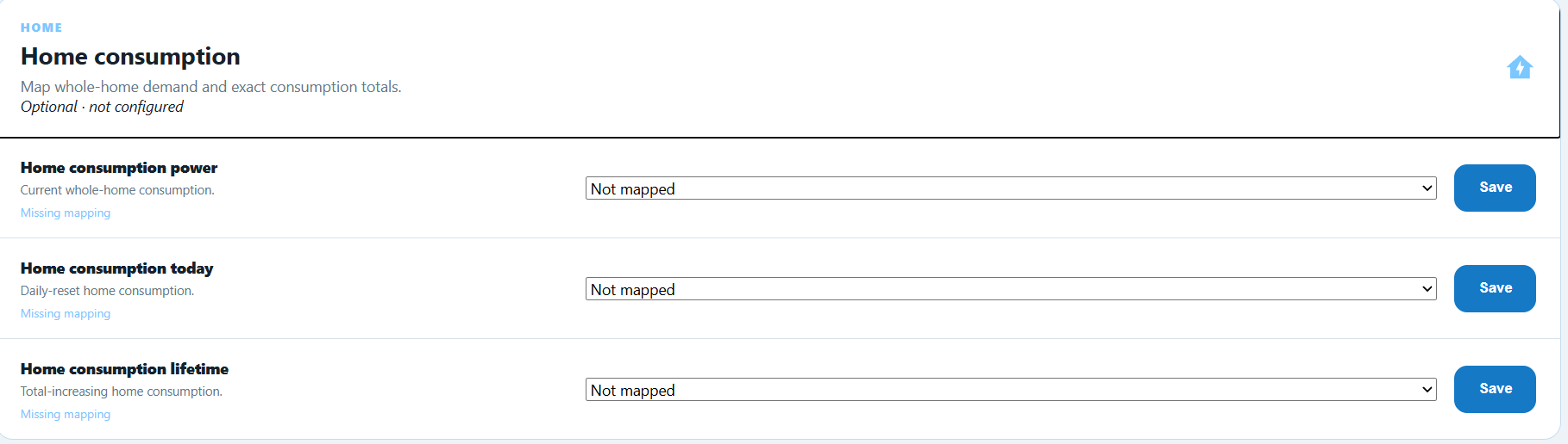

And home consumption is still zero. Maybe it expect always a sensor for home consumptions? I don’t have one.
Ok I got the .16 now. HACS doesn’t show it on top of the list, it still proposes .6… to be kept in mind for the future.
Here the report, nothing has changed.

Thanks, the diagnostic report found the issue.
Your Solar, Grid and Battery mappings are being read correctly. However, Zeus currently has no live Home Consumption Power entity mapped — the report shows house_power_w: null.
At the snapshot shown, Solar was 637 W, Grid export was 439 W and the battery was idle, so Home consumption would be roughly 198 W.
Zeus is currently displaying the missing Home value as 0 W instead of deriving it from the available energy flows. So please do not change your Grid mappings again. I can now reproduce/understand the issue and will correct the fallback calculation ( to show “add sensor” and not 0 ).
P.S. About the report…Looks like your browser is not refresh…Refresh it and must show like this…
So back to the issue: The report shows that your Home Consumption Power sensor is not mapped. With the current Zeus version, this live power input is required for the Home value.
Please map your live total house/consumption power sensor under Energy Sources → Home / Consumption. You do not need to change the Grid configuration again.
Yes I had .6, now with .16 I get the buttons as you showed.
I’m not sure I understand which sensor I should put there: I never saw such a sensor in smart meters so I would need to add a helper using the definition of home consumption, which is (assuming all positive values):
home = grid input - grid output + battery output - battery input + solar output.
Or, when bidirectional (signed) sensors are used,
home = grid - battery + solar
If all of them are filled in (and I have them all), the integration already knows the home consumption.
That’s why I’m puzzled, but I might have misunderstood what you meant.
For example, in the past I had this card for other purposes:
and it does what I mentioned: after filling in grid, battery and solar, it calculates home consumption
You are correct. If Solar, Grid and Battery live power are mapped, Zeus already has enough information to derive Home consumption. A separate Home Consumption sensor should not be mandatory.
In your example, with 637 W solar, 439 W export and no battery flow, Home consumption should be roughly 198 W.
Zeus is currently not applying that fallback calculation when the direct Home sensor is missing, so it shows 0 W instead.
I’ll correct that behavior so Zeus can derive Home consumption automatically from the available live energy flows.
I will release a new version ASAP with this fix ( as I say before Zeus was started for my own needs and system…Now I must change some parts ![]()

Mostly! Just a sign is wrong somewhere.
It has grid 794 W which is “import + export”, but it should be “import - export” because separate import and export entities don’t provide negative values for export, it appears as positive all the time, therefore it should show 219 - 575 = -356 (value verified with the smart meter).
I haven’t tested the battery yet, but even there the discharge (when provided as separate entity) is always positive so it should get subtracted, not summed.
I see/found the bug… I fixed and I add also Dynamic Tariffs.
I’m gonna released ASAP.

If you publish the source I can also give it a look and help more, so that I can do tests on my own and provide you with the working code.
For example, the latest version corrected grid import, but the battery combined flow is still wrong, and home consumption also is 0.
As a very minor remark, I just noticed it: grid export should have the arrow TOWARDS the power pylon. The icons for import and export (only the grid ones!) should be reversed. The arrows for the battery flows are correct.
Other issue: the diagnostics page show the correct grid balance, but the overview and Welcome pages don’t.
