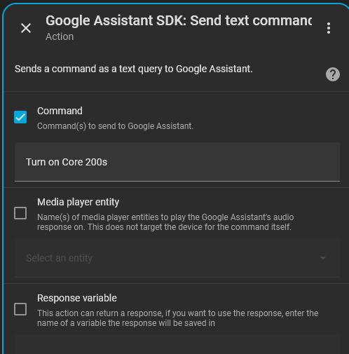

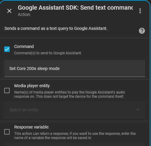

Just a new year update regarding the 200s, since I did not want to disable 2FA on the vesync account I was able to link it through the app to google home then setup the google assistant sdk connection to home assistant.
This allows me to turn it on/off and set fan speeds/modes and turn its display and light on and off by using google_assistant_sdk.send_text_command action as shown here:
This will allow me to keep using it until I do eventually replace it with local only models when I have the funds and they are in stock as I do not want to rely on internet reliant setups as much as possible (i’ll keep this setup for other devices that have local integration issues with sign in etc until they are resolved as I come across them).
The only thing that cannot be seen this way is the filter life but I can always just check that via the app as that is not pulled into the google home link.
