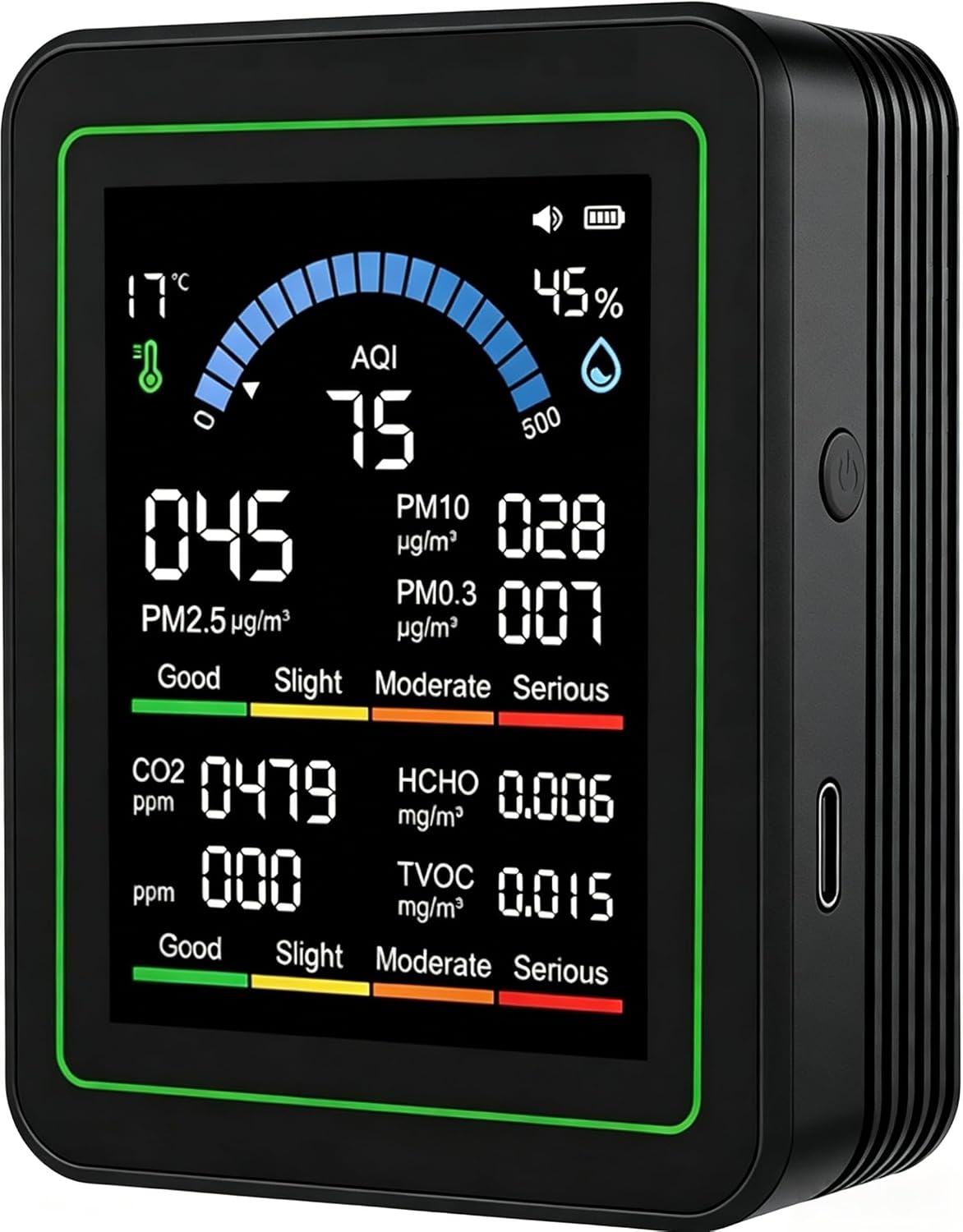

Does anyone know whether it’s possible to get the data out of this device:
Into Home Assistant? I’m guessing this is a white label device sold as other manufacturers which is likely why the brand doesn’t seem to show up as an integration.
I don’t even know how it communicates to its app.

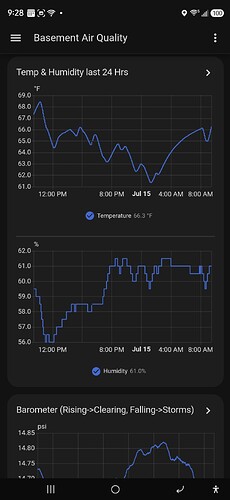

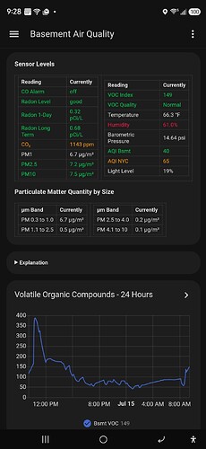

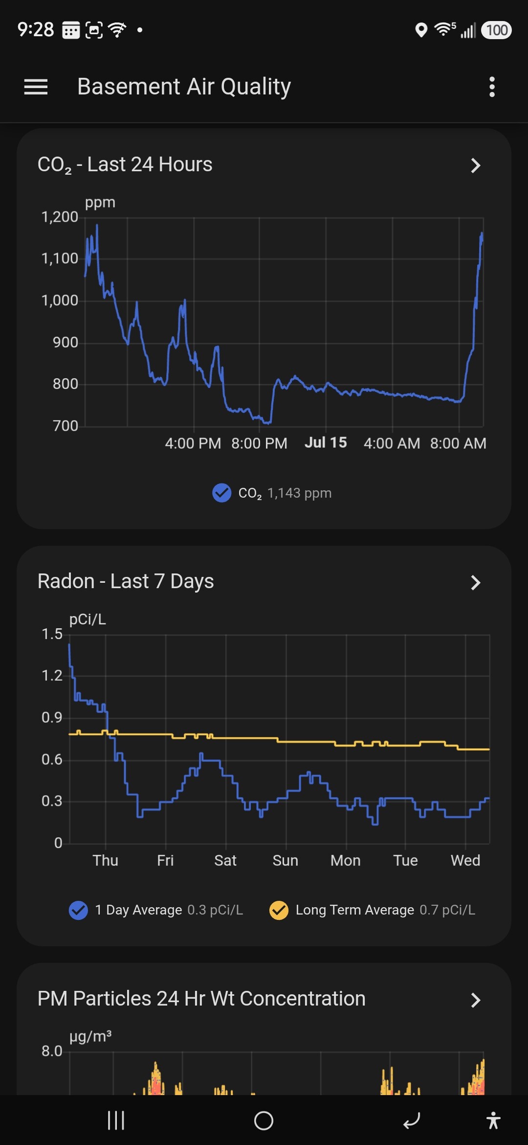

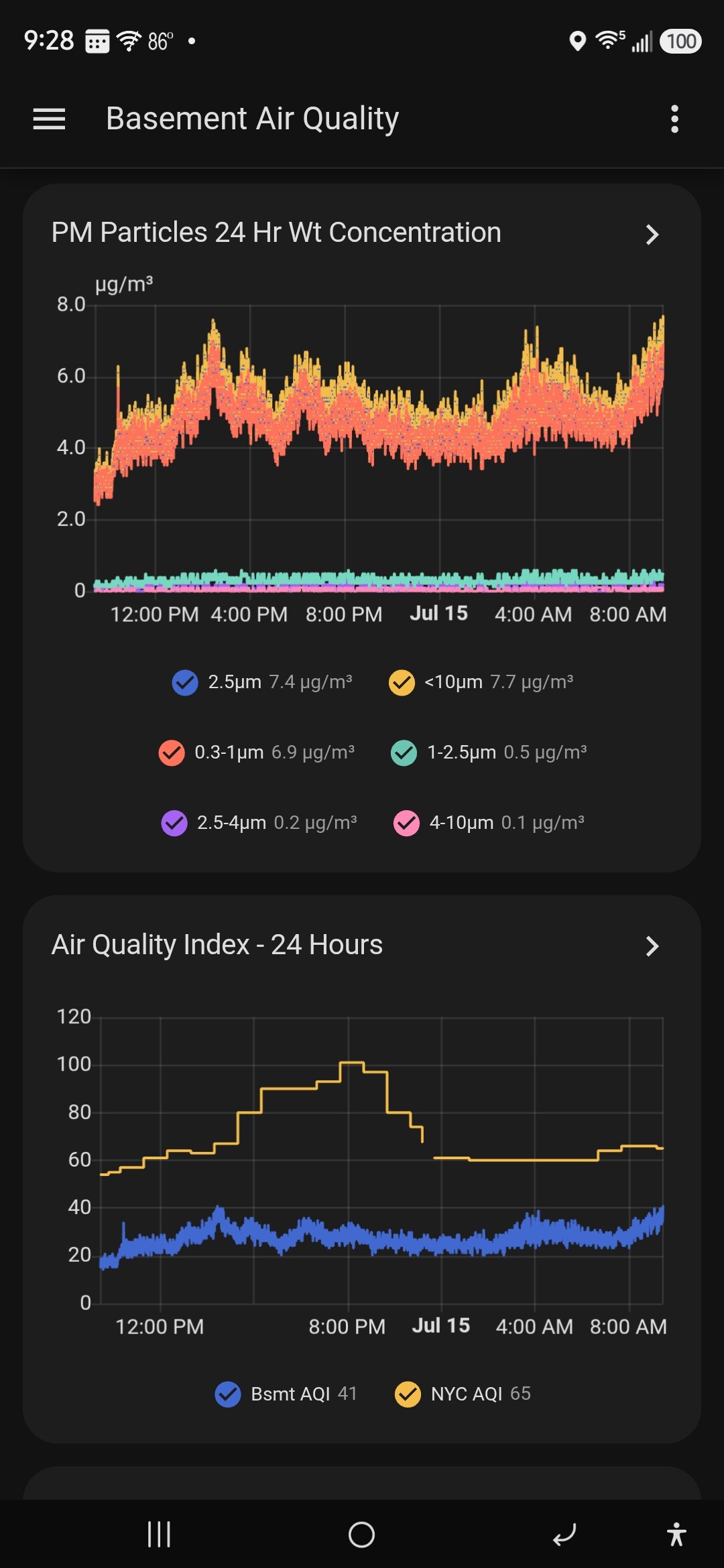

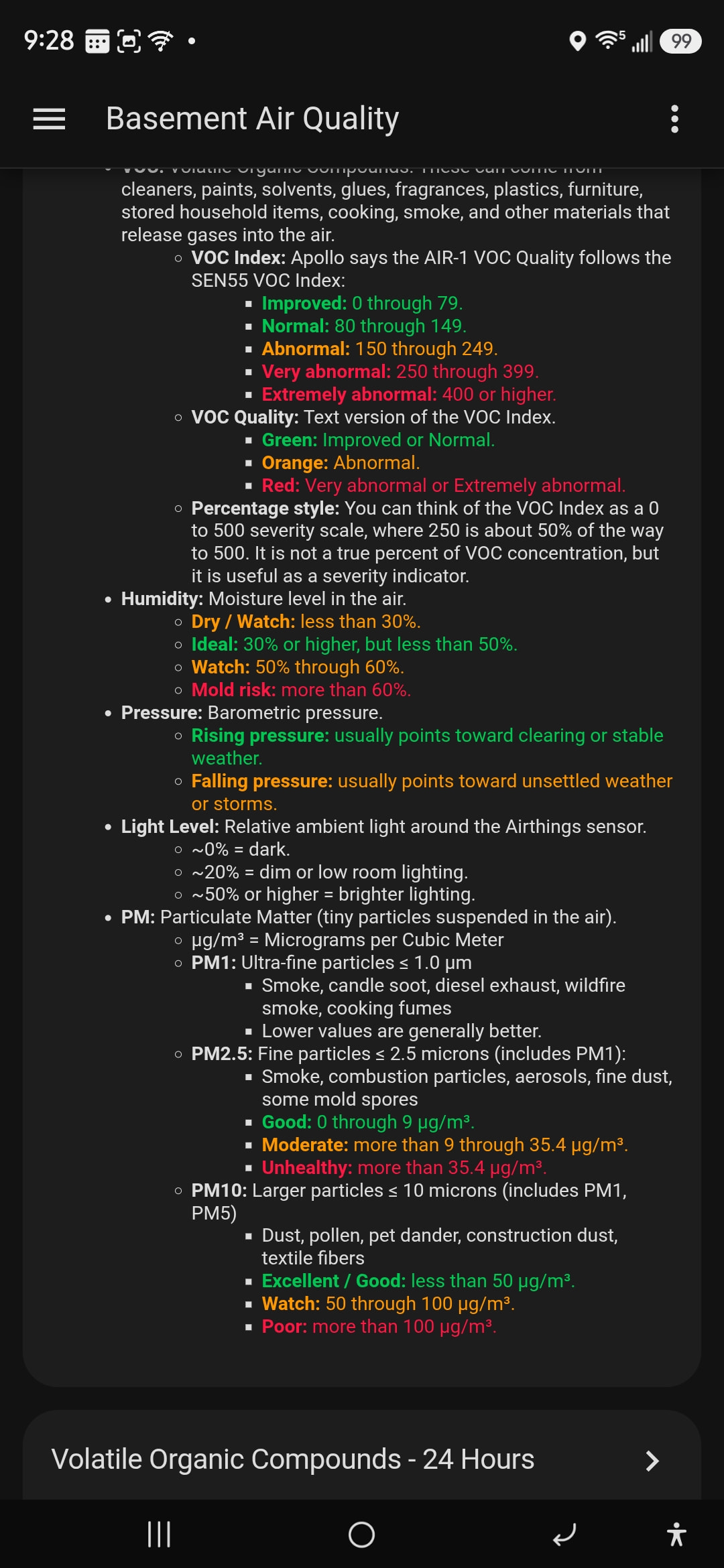

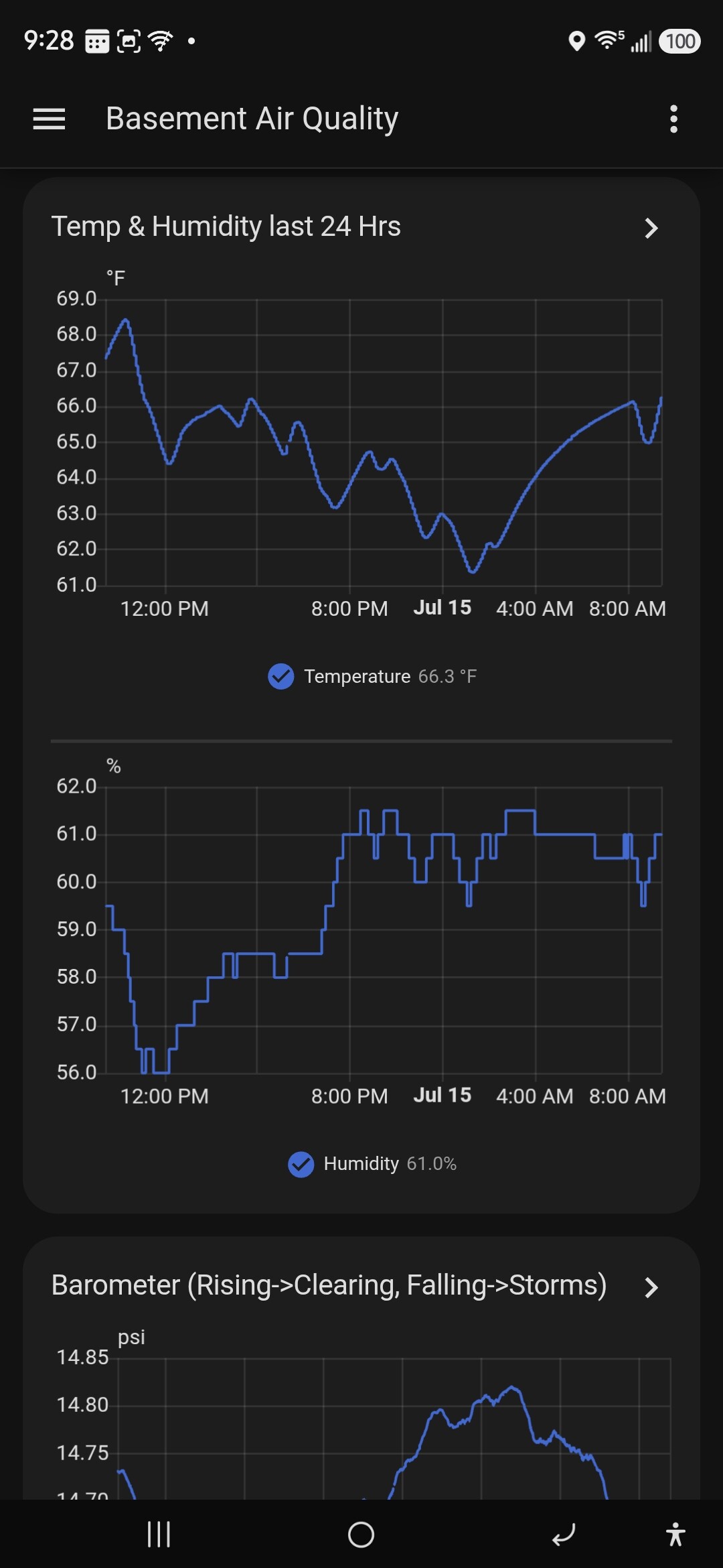

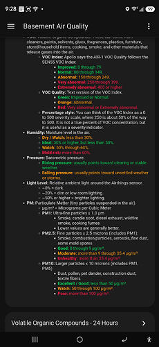

Here is a dashboard I created using the values from both:

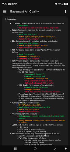

If you look at the first screen shot, you will see a rollup card that says “explanation”. I put that there for myself so I would not forget the meanings of half of these (clicking on it shows the below that open up):

      - type: markdown
        content: |
          <details>
          <summary><b>Explanation</b></summary>
          - **CO Alarm:** Carbon monoxide alarm from the smoke/CO detector.
              - <font color="#00c853"><b>Off:</b> normal.</font>
              - <font color="#ff1744"><b>On:</b> dangerous carbon monoxide may be present.</font>
          - **Radon:** Radioactive gas from the ground. Long-term average matters most.
              - <font color="#00c853"><b>Good:</b> less than 2 pCi/L.</font>
              - <font color="#ff9800"><b>Watch:</b> 2 pCi/L or higher, but less than 4 pCi/L.</font>
              - <font color="#ff1744"><b>Action:</b> 4 pCi/L or higher.</font>
          - **CO₂:** Carbon dioxide. A ventilation and stale-air indicator.
              - <font color="#00c853"><b>Good:</b> less than 800 ppm.</font>
              - <font color="#ff9800"><b>Watch:</b> 800 ppm through 1200 ppm.</font>
              - <font color="#ff1744"><b>High:</b> more than 1200 ppm.</font>
          - **AQI:** Air Quality Index: Bsmt is local Apollo. NYC is regional AirNow.
              - <font color="#00c853"><b>Good:</b> 0 through 50.</font>
              - <font color="#ff9800"><b>Moderate:</b> 51 through 100.</font>
              - <font color="#ff1744"><b>Unhealthy:</b> 101 or higher.</font>
          - **VOC:** Volatile Organic Compounds. These can come from cleaners, paints, solvents, glues, fragrances, plastics, furniture, stored household items, cooking, smoke, and other materials that release gases into the air.
              - **VOC Index:** Apollo says the AIR-1 VOC Quality follows the SEN55 VOC Index:
                  - <font color="#00c853"><b>Improved:</b> 0 through 79.</font>
                  - <font color="#00c853"><b>Normal:</b> 80 through 149.</font>
                  - <font color="#ff9800"><b>Abnormal:</b> 150 through 249.</font>
                  - <font color="#ff1744"><b>Very abnormal:</b> 250 through 399.</font>
                  - <font color="#ff1744"><b>Extremely abnormal:</b> 400 or higher.</font>
              - **VOC Quality:** Text version of the VOC Index.
                  - <font color="#00c853"><b>Green:</b> Improved or Normal.</font>
                  - <font color="#ff9800"><b>Orange:</b> Abnormal.</font>
                  - <font color="#ff1744"><b>Red:</b> Very abnormal or Extremely abnormal.</font>
              - **Percentage style:** You can think of the VOC Index as a 0 to 500 severity scale, where 250 is about 50% of the way to 500. It is not a true percent of VOC concentration, but it is useful as a severity indicator.
          - **Humidity:** Moisture level in the air.
              - <font color="#ff9800"><b>Dry / Watch:</b> less than 30%.</font>
              - <font color="#00c853"><b>Ideal:</b> 30% or higher, but less than 50%.</font>
              - <font color="#ff9800"><b>Watch:</b> 50% through 60%.</font>
              - <font color="#ff1744"><b>Mold risk:</b> more than 60%.</font>
          - **Pressure:** Barometric pressure.
              - <font color="#00c853"><b>Rising pressure:</b> usually points toward clearing or stable weather.</font>
              - <font color="#ff9800"><b>Falling pressure:</b> usually points toward unsettled weather or storms.</font>
          - **Light Level:** Relative ambient light around the Airthings sensor.
              - ~0% = dark.
              - ~20% = dim or low room lighting.
              - ~50% or higher = brighter lighting.
          - **PM:** Particulate Matter (tiny particles suspended in the air).
              - µg/m³ = Micrograms per Cubic Meter
              - **PM1:** Ultra-fine particles ≤ 1.0 µm
                  - Smoke, candle soot, diesel exhaust, wildfire smoke, cooking fumes
                  - Lower values are generally better.
              - **PM2.5:** Fine particles ≤ 2.5 microns (includes PM1):
                  - Smoke, combustion particles, aerosols, fine dust, some mold spores
                  - <font color="#00c853"><b>Good:</b> 0 through 9 µg/m³.</font>
                  - <font color="#ff9800"><b>Moderate:</b> more than 9 through 35.4 µg/m³.</font>
                  - <font color="#ff1744"><b>Unhealthy:</b> more than 35.4 µg/m³.</font>
              - **PM10:** Larger particles ≤ 10 microns (includes PM1, PM5)
                  - Dust, pollen, pet dander, construction dust, textile fibers
                  - <font color="#00c853"><b>Excellent / Good:</b> less than 50 µg/m³.</font>
                  - <font color="#ff9800"><b>Watch:</b> 50 through 100 µg/m³.</font>
                  - <font color="#ff1744"><b>Poor:</b> more than 100 µg/m³.</font>
          </details>

      - type: history-graph
        title: Volatile Organic Compounds - 24 Hours
        hours_to_show: 24
        entities:
          - sensor.basement_apollo_air_1_air_sensor_sen55_voc
        card_mod:
          style: |
            .card-header {
              font-size: 18px !important;
              font-weight: 400 !important;
        title: CO₂ - Last 24 Hours
        hours_to_show: 24
        entities:
          - sensor.basement_apollo_air_1_air_sensor_co2
        card_mod:
          style: |
            .card-header {
        title: Radon - Last 7 Days
        hours_to_show: 168
        entities:
          - sensor.basement_airthings_wave2_radon_sensor_radon_1_day_average
          - sensor.basement_airthings_wave2_radon_sensor_radon_longterm_average
        card_mod:
          style: |
            .card-header {
        title: PM Particles 24 Hr Wt Concentration
        hours_to_show: 24
        entities:
          - sensor.basement_apollo_air_1_air_sensor_pm_2_5mm_weight_concentration
          - sensor.basement_apollo_air_1_air_sensor_pm_10mm_weight_concentration
          - sensor.apollo_air_1_2b9738_pm_0_3_to_1_mm
          - sensor.apollo_air_1_2b9738_pm_1_to_2_5_mm
          - sensor.apollo_air_1_2b9738_pm_2_5_to_4_mm
          - sensor.apollo_air_1_2b9738_pm_4_to_10_mm
        card_mod:
          style: |
            .card-header {
        title: Air Quality Index - 24 Hours
        hours_to_show: 24
        entities:
          - sensor.basement_apollo_air_1_air_sensor_nowcast_aqi
          - sensor.airnow_aqi
        card_mod:
          style: |
            .card-header {
        title: Temp & Humidity last 24 Hrs
        hours_to_show: 24
        entities:
          - sensor.basement_airthings_wave2_radon_sensor_temperature
          - sensor.basement_airthings_wave2_radon_sensor_humidity
        card_mod:
          style: |
            .card-header {
        title: Barometer (Rising->Clearing, Falling->Storms)
        hours_to_show: 168
        entities:
          - sensor.basement_apollo_air_1_air_sensor_dps310_pressure
        card_mod:
          style: |
            .card-header {
Hope that helps! I know yes it gets a little pricey, but it is less expensive than cancer and your health is worth it LOL
