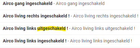

The problem is now that this doesn’t work every time…sometimes there is one aircon not on (not always the same one !).

And if the state changes I send myself an e-mail.
I left my house and I received 3 e-mails :
Schermafbeelding 2022-01-22 175539
But when I came back I received these e-mails :
Schermafbeelding 2022-01-22 175732
As you can see my “Airco living links” is first switched on, but also switched off after.
In my script “Airco x op y graden” I already have my repeat routine, that I now run twice to solve this but of course I would prefer to find the reason…
I already put some delay’s (the 5 seconds), but this doesn’t work.
Somebody an idea ?
