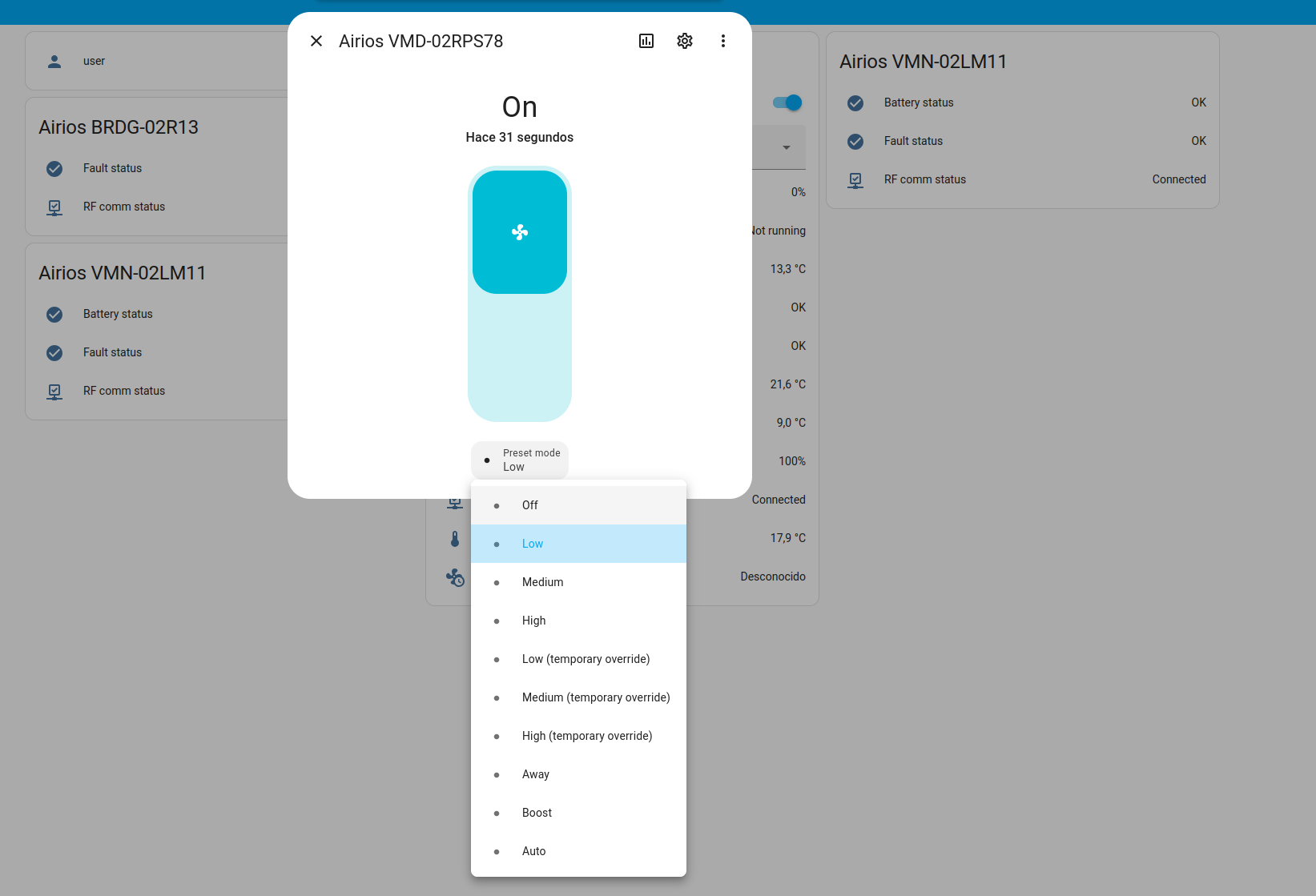

With that, it seems to work well. Next thing I am missing is having a Climate entity that also allows to update the speed, does anyone have something like that?

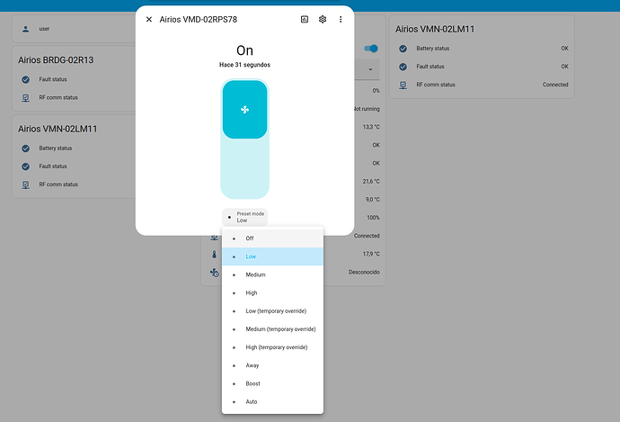

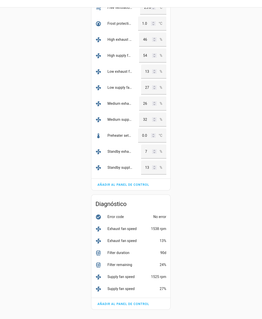

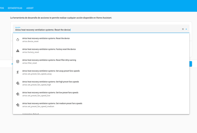

Getting there:
I want to merge to core as an official integration so it will take some time, there is a lot to do (publish library, upload brand assets, write tests, etc. etc.).
All the pieces are in place:
- Library: GitHub - scabrero/pyairios
- Brands: Add icons and logos for Airios by scabrero ¡ Pull Request #6724 ¡ home-assistant/brands ¡ GitHub
- Documentation: Documentattion for Airios integration by scabrero ¡ Pull Request #37924 ¡ home-assistant/home-assistant.io ¡ GitHub

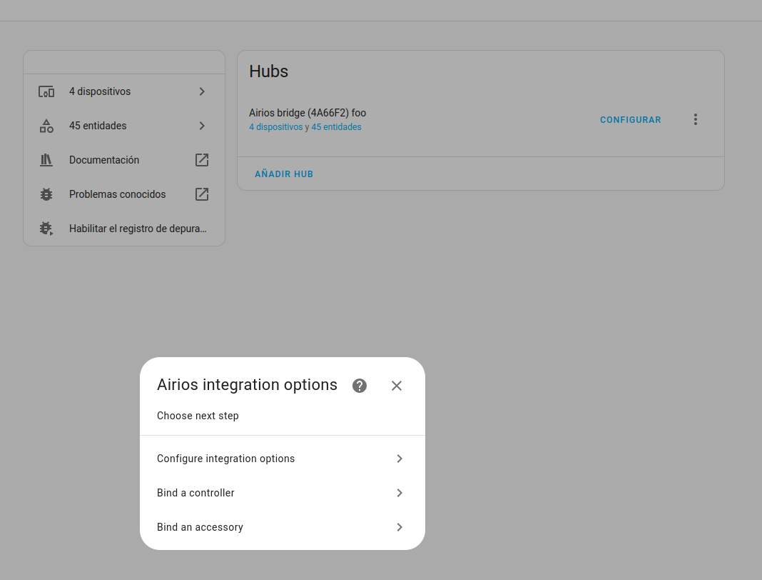

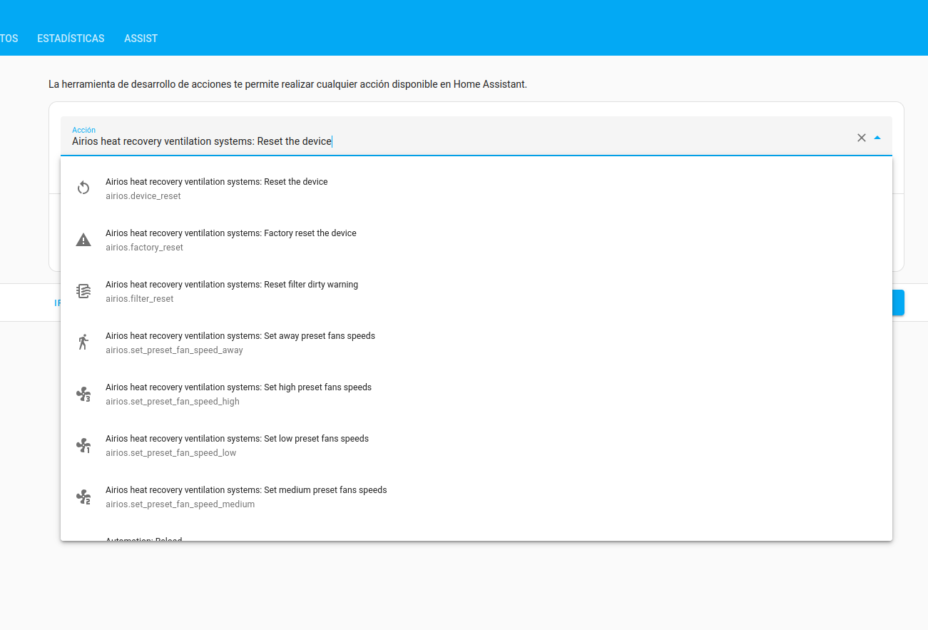

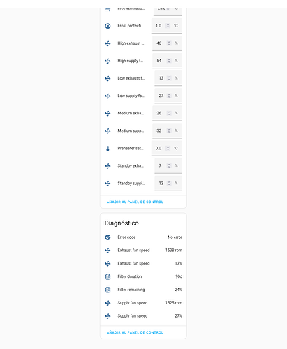

- Integration: Airios integration for ventilation systems by scabrero ¡ Pull Request #140418 ¡ home-assistant/core ¡ GitHub (just fan platform for now, full branch GitHub - scabrero/home-assistant at airios)
Hi, I apologise for my ignorance but I canât figure out how youâve got HA to talk to the Airios BRDG-02R13 RF bridge. I have a Siber DF Evo 1 with a DFEVORFRS485 de Siber I want to integrate in HA (HA Yellow) but the connectivity part I canât figure out. Can you help?
please check homeassistant-airios-component/README.md at main ¡ scabrero/homeassistant-airios-component ¡ GitHub and homeassistant-airios-component/doc/1-brdg02r13.md at 5b02fd14e13f1bbcd662b81031ba98bb733af68f ¡ scabrero/homeassistant-airios-component ¡ GitHub
Please open an issue in github if the documentation is not clear enough.
