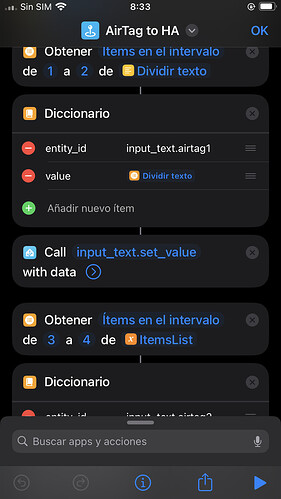

Hi! these are the steps on my Shortcut. As previously said, I used “Se comparte con Manuel” to split the Objects because it was convenient for me, if there is no repeated value for each Object in your case, the * keeps being a nice option.

The change is that I duplicated the count element part and splitted as follows:
From 2 to 4 (4 is the change from the original value
From 4 to count (as in the original value)
Starting from this I then duplicated the following actions so created another dictionary
This was the tricky part because even if the variable as same name (still in Spanish) this time i found a way to link to 2 different variables
And finally this variables populate another call to service
