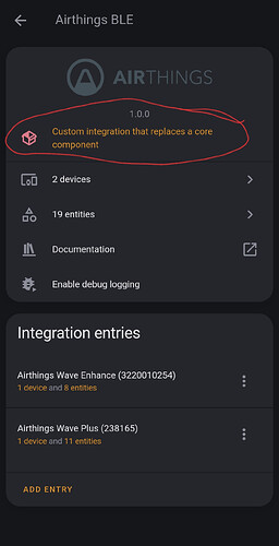

Use this for now, add it to HACS.
Thanks for surfacing this! This works perfectly via Bluetooth Proxy and solve the problem I described on discord Discord

Not sure, I don’t think so, but it’s very easy to download and install the linked repo to add the device to core.
The integration hasn’t been updated yet for the Wave Enhance. The Beta repo works though. I opened an issue to find out how we can get the Wave Enhance supported in the HA integration: Request: add Wave Enhance support for mainline HA integration · Issue #1 · LaStrada/HA-Airthings-BLE-beta · GitHub
