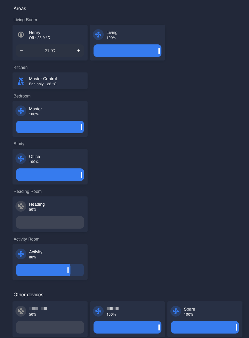

An issue with display names should be very easy to fix, can you show a screenshot of what you’re seeing?
This is how the zone entities come up:
In terms of how they work its fine, its more that its fan.living as an example.
In our system this is controlling how open/closed the actuator to that zone is. I’m guessing in other parts of the world, each zone may have its own fan.
Ah the display names are actually fine. I just implemented zone control as fan entities in home assistant because it was easy - the fan% maps well to the zone%. I suppose it’s a bit of a hack. Perhaps cover is what I should actually be using.
