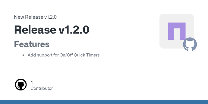

@Dsx2 I’ve published v1.2.0-rc1 which includes time entities for the on and off quick timers. There are also a couple of custom services to set the timer to trigger after a specified delay (similar to pressing and holding on the AirTouch console power button) and clear an active timer.
You can find more info about the new features in the README
You may need to enable the HACS pre-releases switch for the airtouch integration to see the update. It is called switch.polyaire_airtouch_pre_release for me.
Let me know whether this lines up with what you wanted.
v1.2.0 of the integration is now officially released.
The new feature is support for seeing the current On/Off Quick Timers set from the AirTouch console and also setting the timers. This feature is available for both AirTouch 4 and AirTouch 5 systems.
