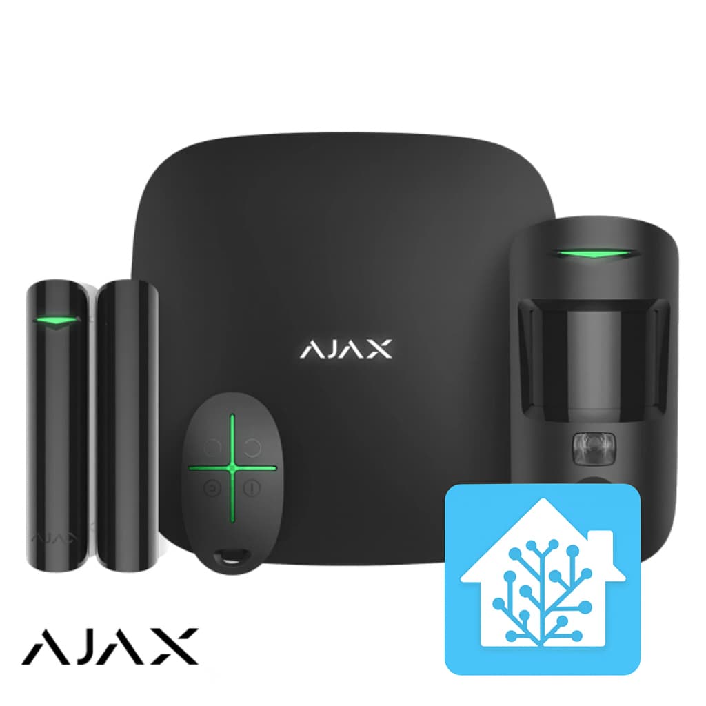

Hello again HA forum!
In continuation of giving back to community I proudly present - AJAX Security System Integration in Home Assistant
This extensive Github article covers in depth integration of AJAX into HA, how Security Alarm systems/hubs work, communicate and can we take advantage of closed security systems like it. Plus configuration of ALARMO integration and how create practical ALARMO cards for Dashboard UI.
Here is the link to Github:
Article
And a Youtube demonstration video:
Youtube
I really hope this would help you integrate your AJAX/maybe other vendor security alarm into HA!
I would love to hear out your experience with such integrations and what hacks have you used!
