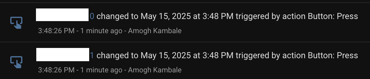

Has anyone had trouble with activating their door relays? My building has two relays. I’ve tried both and neither are opening my front door. My home assistant logs show them triggered too. I’ve also refreshed my integration a few times, but no luck. Any suggestions on how to debug?
You can enable debug logging for the integration and then see in the Home Assistant logs whether the API call was made successfully.
To enable the debug logs:
  1. Open Settings
  2. Select Devices & services
  3. Select the Akuvox integration
  4. Select the Enable debug logging
Thanks! I am new to Home Assistant so I didn’t think to look in the logs. It turns out my requests to connect to the relays had auth issues. I was manually changing the package code earlier to get it to work which is probably why it wasn’t accessing credentials correctly. I completely uninstalled the package and re-installed the beta 3 version. It is now working! And my doorbell automation is working too, which is great!
