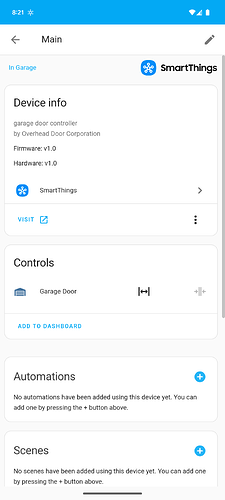

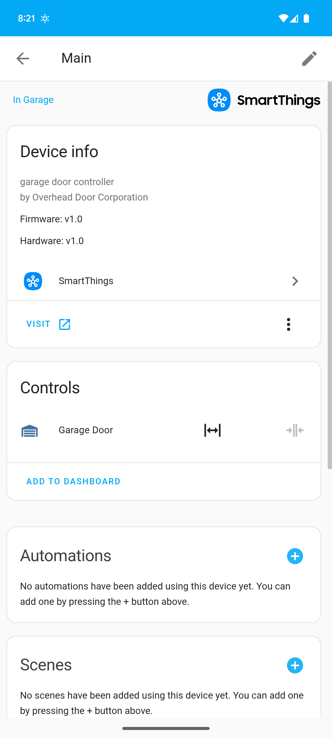

Genie Aladdin integrates easily with SmartThings. Pair with the app, then reload in Home Assistant.
Any chance there will be a new integration in the near future. This seems to have just fallen by the wayside with no news since Genie decided not to play nice with their “official” integration.

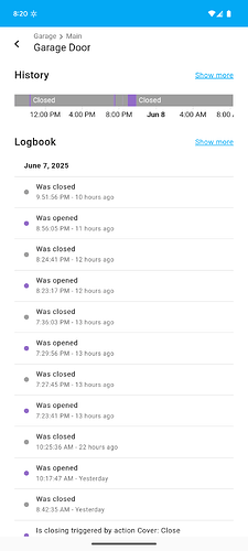

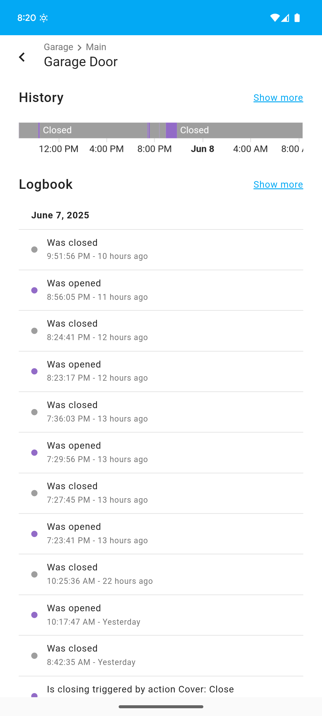

I looked at this but ended up going a different direction. The Aladdin Connect also syncs with Samsung’s Smart Things, and integrating Smart Things into HA was easy and surfaces the control and the state. Easy setup and no developer account. Granted it is two stage, but it works well.

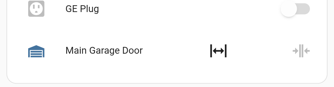

I changed the icon:
State history:
