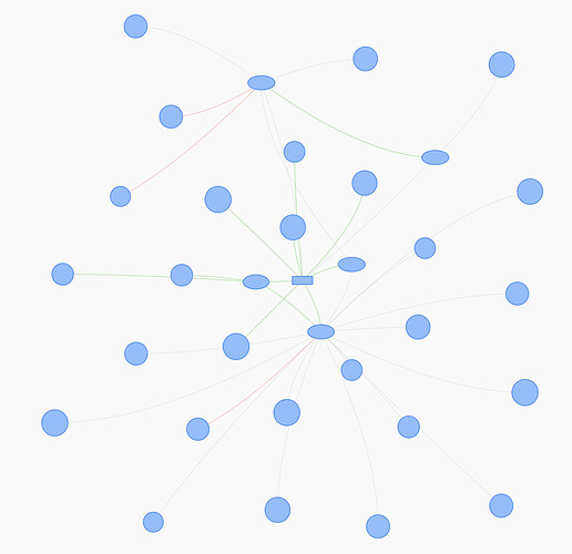

What integration do you use to connect the conbee 2? As far as I know all integrations in HA offer a map you can determinate how the devices are connected.
The devices do not always connect as you would expect…
Hi there,
I connect via ZHA. The card is there, but I don’t know that I can set the connection.
Greetings Werner

It’s a mesh-system. No way known to me to interfere - Even if the human eye finds a better connection.
Your word made me think that you don’t know how the window-sensors are connected. Do they connect to the roller shutters? Even if close together this doesn’t mean they connect direct.
If they are connected to the rollter shutters the only way I can think of is to connect a second zigbee controller to HA (And this can’t be ZHA, as there is only one instance usable - You may use a zigbee2MQTT-Stick) and to separate the security relevant parts from the convenience parts.
