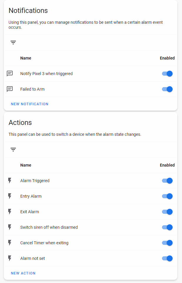

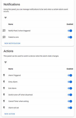

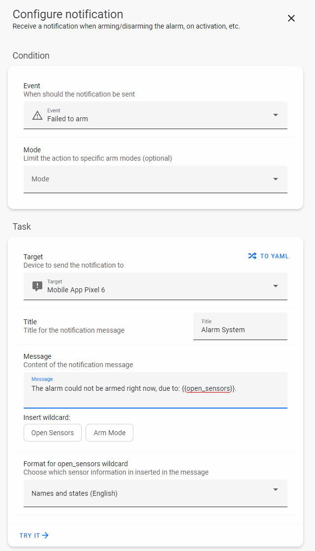

Alarmo has notifications for this built in :
i see it now. thanks! strange that there is no open sensors though.
