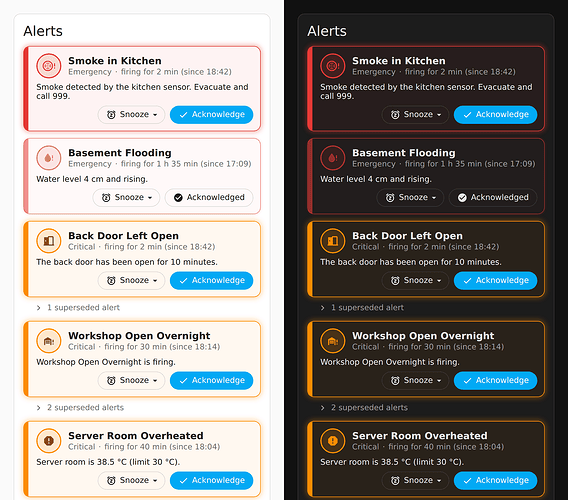

  • Eight kinds of alert: manual (fired and dismissed by your automations, and optionally ending by itself), state, threshold (with hysteresis), template, on/off (separate criteria for on and off), alert state (e.g. “unacknowledged for 30 minutes”), trigger, and bus event.
  • Configured entirely in the UI, with no YAML requirement.
  • A Lovelace card that ships with the integration (no separate install). It shows every firing alert coloured by priority, with acknowledge, snooze, and dismiss buttons, plus an admin card for disabling and suspending alerts.
