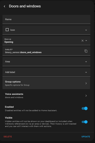

Door and window group
binary_sensor.doors_and_windowswith all monitored doors and windows.
Using Helpers go to helpers - group - binary sensor group to create a binary group sensor.
