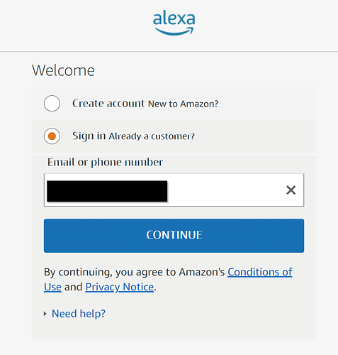

The problem is the new three page login sequence with email, then password, then 2SV.
AMP was programmed to do the callback after two pages (the way the Amazon login used to be) but gets an ā€œunsuccessfulā€ response after only two pages since the login sequence did not finish all three pages and AMP returns you to the previous (first) page to try again. So…
At this screen, select the first option
Enter ā€œx xā€ for First and last name and click CREATE YOUR AMAZON ACCOUNT
When that fails, select Sign in Already a customer?
The page then changes to show both email & password on the same page. (which is still the first page in the callback sequence)
Now you can select SIGN IN which then proceeds to the 2nd page which is Two-Step Verification
and the callback to HA will then occur where it will test if your email, password & OTP login was successful or not. If not, it sends you back to the first page in Amazon’s new 3 page sequence.
