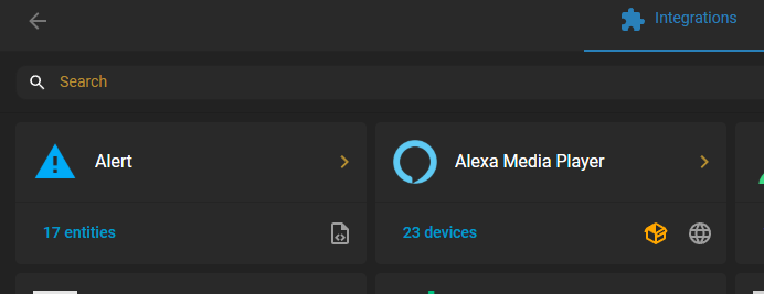

do you see this:
if not then you need to go to the bottom right of the integrations tab and select “add integration” and the select “Alexa Media Player” from the list.
If you do see that integration in the screenshot above post a screenshot of yours so we can see to compare it.
