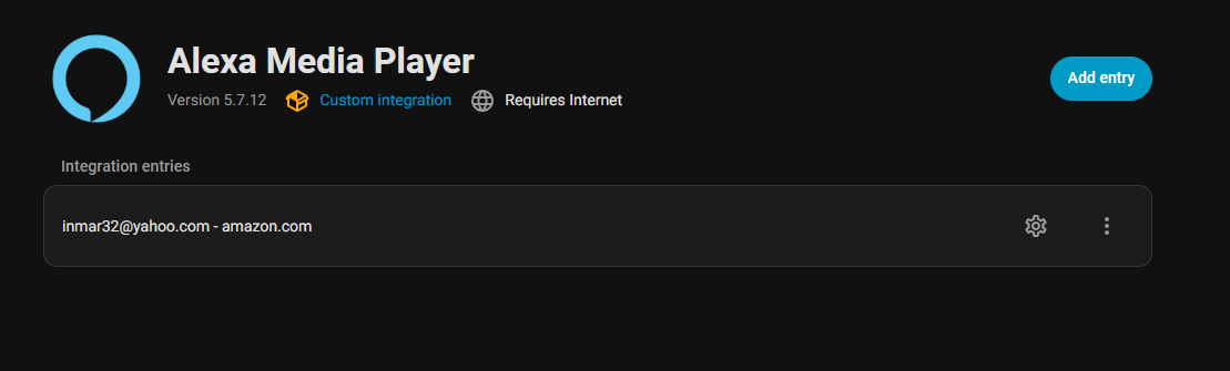

I’m basically seeing the same thing.
every time I restart HA I have no idea if the devices will return or not.
As you say the integration itself doesn’t show any errors in the UI but none of the devices or services are available. It’s pretty random whether it works or not. Once it initializes correctly after a restart then everything continues to work as expected. Until the next restart then it’s a roll of the dice if it comes back correctly.

Are you running the latest version?
I assume so. It’s 5.7.12 and HACS hasn’t notified me of any updates.
the same thing was happening on v 5.7.11 before that one as well.
