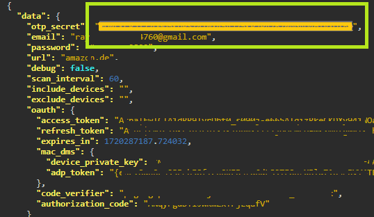

So, I accessed the file via nano-editor by typing the following command into the terminal:
nano /config/.storage/core.config_entries
There I searched for “Amazon” (by pressing CTRL + F) and the first result I got, had the secret I was searching for, see picture in appendix:
