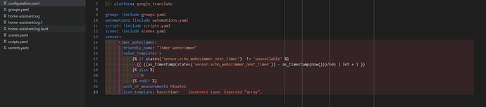

Hi i’m really new to this. I’ve been following your steps but falling at the first hurdle. I’m pasting your code
into the config.yaml entry on Studio Code Server. on the last line i get an error saying Incorrect type. Expected “Array”
You need to add the platform configuration info, as is shown in Post #8. Also, make sure to put the entity_id of your sensor, not the original value (unless your echo just happens to be called ‘echo_wohnzimmer’ too)
