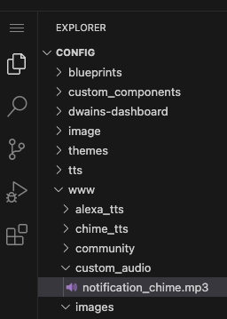

Where the mp3 file is located:

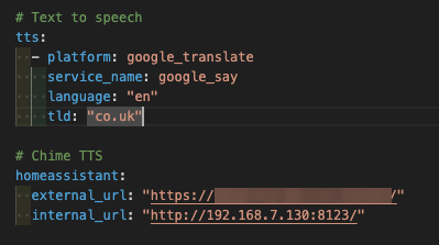

configuration.yaml

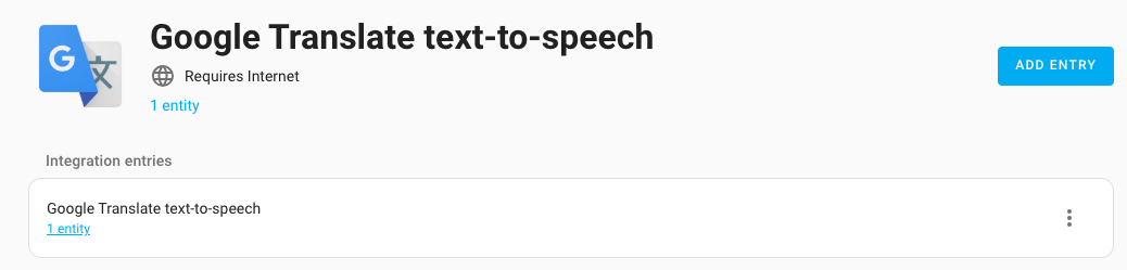

Google Translate TTS is installed too:
