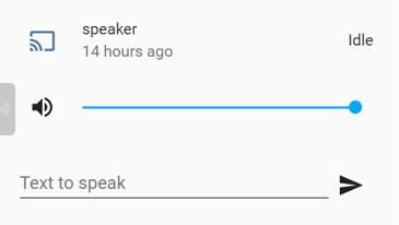

Hello everyone, I would like to send TTS to Alexa directly on the dashboard text input field. Does somebody has any idea? something like in the photo
here’s an automation that will play what’s in an input_text.
just create a card that points to your input_text helper.
