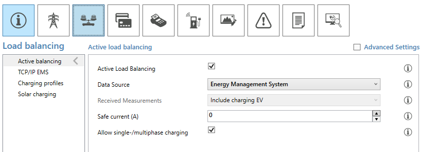

I also have an Alven wallbox with the activ load balancing licence. I can also charge the car and switch the charging power. However, if I don’t charge the car for a few minutes, I have to reconnect the charging cable every time. Which setting is wrong? Does anyone have any ideas?
I have made these settings in the ACE service installer:
But I can’t activate the Solar Cahrging.Alfen Eve Pro EV chargepoint interface via TCP modbus - #275 by aerrow5

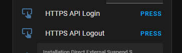

I also installed my wallbox and want to integrate it.
Have you closed myEVE mobile app and ACE installer?
Wallbox accepts ONLY ONE connection at a time.
If you enable the device in HA you wont be able to use the mobile app.
In my case, the logout button also does not work, i had to “disable” and “enable” the whole device in HA, to be able to connect via ACE again.
