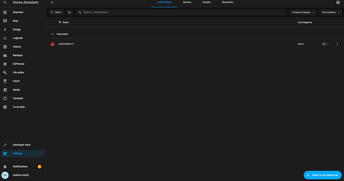

Before I start explaining the problem I am running into, I should let you know that I am not an advanced user - although I have learned a bit of this and that. I would say I am a beginner-level or an intermediate-level user.
I recently ran into a problem one day when I wanted to create a new automation. I went to Settings > Automations & scenes > Automations, and all my automations are gone and only a single automation (one that I did not create) appeared.
I am not able to delete it from the GUI, but I succeeded in getting rid of previously using File Editor and messing with Automations.yaml.
I changed the name of the old yaml file from automations.yaml to automations.old, and proceeded with creating a new automations.yaml file. As soon as I did that and restarted the server, I started seeing automation 0 again. I also tried a complete reboot too.
There are multiple automations in my automations.yaml, some of which I want to use. How can I fix this?
I should also point out that we have frequent power outages and Home Assistant shuts down whenever there is an outage. I do not have any power backup for it yet.
automations.yaml, configuration.yaml, and Home Assistant Core logs are below:
