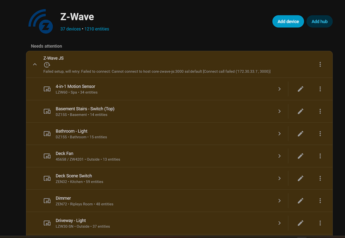

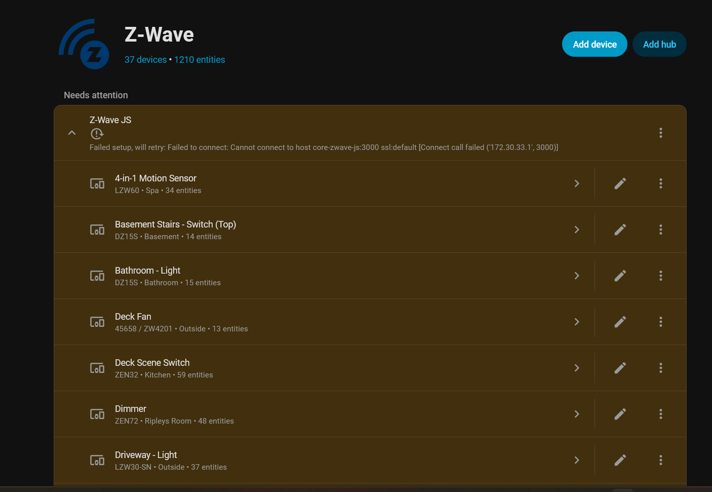

So I just noticed over the last few days that automation and everything failing and when I went to investigate I found the following in Z-Wave intagration
I don’t want to do anything to have to reset EVERYTHING up again So I wanted to check in with others. It seems like all my devices that were added to HA are all unknown and when I look in Z Wave JS they all work fine. Not sure what happened here but not sure what to do either to reconnect these. Any help would be appreciated

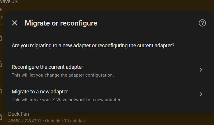

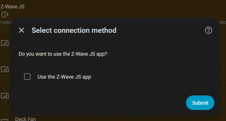

Anyways on the Z-Wave integration Settings > Devices > Zwave where it shows that error you need to hit the 3 dots to the right of the error. Then choose reconfigure the current adapter, then just submit leaving the Use Z-Wave JS blank… this takes you to a screen where you can specify the JS UI actual URL which was ws://a0d7b954-zwavejs2mqtt:3000
