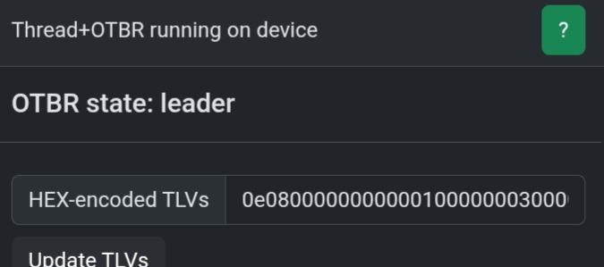

A day later I noticed this on the web interface of the SLZB-MR1U:

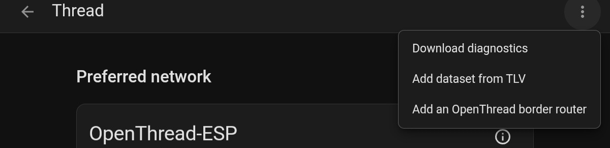

and this on the settings page of the Thread integration:
So I copied the hex encoded TLVs and pasted them in the Add dataser from TLV, synchronized the Thread credentials and Lo and Behold, commisioning works, everything looks stable.
