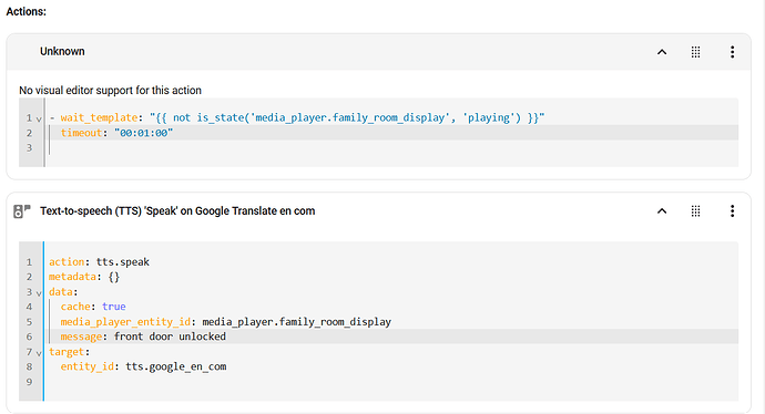

I’m trying to use your template. Not sure where I should put it.
This is incorrect since I get an error message.
Message malformed: expected dictionary @ data['actions'][1]['choose'][8]['sequence'][0]
