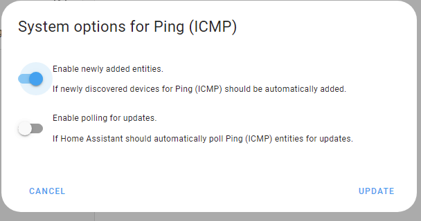

If the integration has no “scan_interval” supported and is controlled in UI -a user may switch off a periodical polling:
and then update entities by that “homeassistant.update_entity” service.
