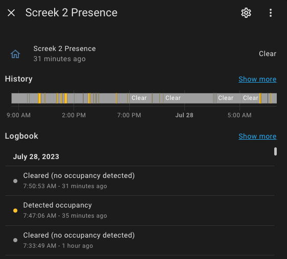

Given that you are triggering your automations on the ‘presence’ sensor shouldn’t make any difference, because your screenshot for that sensor doesn’t appear to show it triggering multiple times at once, and thats what your automation trigger is based on.
Scrolling down the logbook for that sensor, you absolutely don’t see any situations where its toggling on and off rapidly ?
Not sure what you mean by rapidly. All of these are the amount of time I would expect for someone walking into the kitchen, grabbing something out of the fridge, and leaving. Or perhaps someone walking into and out of the kitchen repeatedly with a laptop in hand.
And of course a cat jumping onto the counter repeatedly in the middle of the night. Cat, I see what you’re doing.
